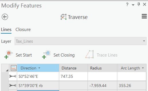

Can you help with entry of this traverse using ArcGIS Pro 2.8.2?
Segment: Curve
Length: 355.26'      Radius: 7959.44'
Delta: 002°33'26"      Tangent: 177.66'
Chord: 355.23'      Course: S87° 04' 17"W
Course In: S01° 39' 00"E      Course Out: N04° 12' 26"W
"...THENCE leaving said south right of way line South 00°52' 45" East, a distance of 747.35 feet, to the northerly right of way line of roadway and the beginning of a non-tangent curve to the left from which point the radius point bears South 1°39'00" East; THENCE 355.26 feet along said northerly right of way line the arc of said curve to the left, having a radius of 7959.44 feet, through a central angle of 2°33'26" and a chord bearing of South 87°04'17" West; ..."
Thanks for any help!
AmyAndis
Hello,
To enter this into the traverse it would look like screenshot below, you will have to use the RB, radial bearing override for the non tangent curve described here:
"a non-tangent curve to the left from which point the radius point bears South 1°39'00" East"

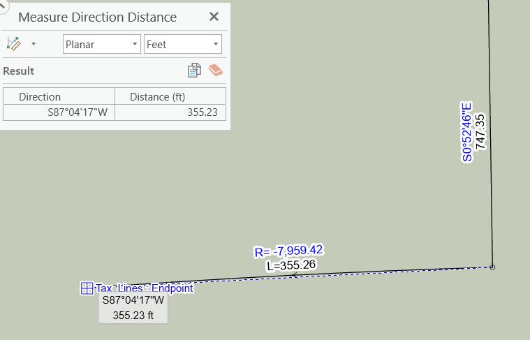

To check this you can use the Direction Distance measure tool to verify the chord direction and distance are correct:
"Chord: 355.23'      Course: S87° 04' 17"W"
