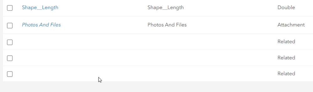

I published a gdb from ArcPro with relationship classes in it. The first time I published it to AGOL I couldn't get featuresetbyname to work. This led me to the data tab where I realised I couldn't see my relationship class between the parent polygon and child table. I thought I had named these relationships when I created them in ArcPro.

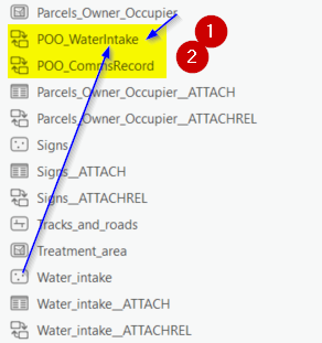

I downloaded the feature service as an fgdb back into pro to try and fix this. I right clicked on the relationship class in the ArcPro Catalog and selected rename.
This is what it looks like and what I expected the two relationship class names to look like in AGOL.
I published it as a new feature service to AGOL, but am still getting the empty name. Why is this, and how do I fix it?
This is what it looks like in AGOL.
This is the third time I am republishing it over the last 2ish years. The first time I didn't notice this issue. The second time (a few months ago) I noticed this issue with 3/5 relationship classes. Today I see the issue with 3/3 relationship classes. I have removed the others.
