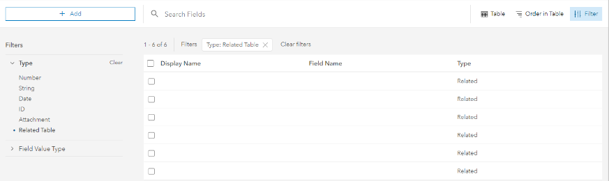

Hello,
I downloaded a FGDB which includes a point layer and 6 related inspection tables from AGOL. In Pro added new names to an existing domain, deleted a field from the feature class that was supposed to be of Data Type Date but was incorrectly created as Text, recreated the field with Data Type Date, tried both overwriting and re-publishing to AGOL and each time the related table Display Names and Field Names show up blank in the Data tab.
I cannot select anything below the Display and Field Names in order to edit the names. Layers show up fine in Field Maps and Field crews can add data but I cannot re-create Arcade expressions because FeatureSetByRelationshipName( ... ) is blank.

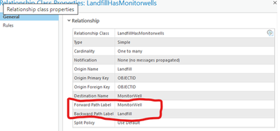

Some additional info. I found that the forward and backward labels within the relationship class properties are blank in Pro. Not sure if this is part of the issue but this is what the dialog should look like according to online documentation:
And this is what mine looks like (no “Forward Path Label” or “Backward Path Label” option to edit):

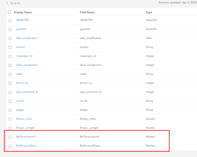

I downloaded a GDB from AGOL, created a new GDB, used feature class to feature class tool to convert 3 features classes from the old to the new GDB, then created 2 new relationship classes, zipped the GDB, uploaded to AGOL and the display name online is the relationship class name.
Python commands (with "layer1", "layer2" and "layer3" being used as tests for display name and "RelTerrainsActifs" and "RelTerrainsPlaces" as relationship names):
arcpy.management.CreateRelationshipClass("terrains", "actifs", "RelTerrainsActifs", "SIMPLE", "layer2", "layer1", "NONE", "ONE_TO_MANY", "NONE", "terrain_no", "terrain_no")
arcpy.management.CreateRelationshipClass("terrains", "places", "RelTerrainsPlaces", "SIMPLE", "layer3", "layer1", "NONE", "ONE_TO_MANY", "NONE", "terrain_no", "terrain_no")

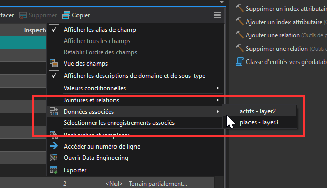

ArcGIS Pro result (in French but you can see the relation names "layer2" and "layer3":

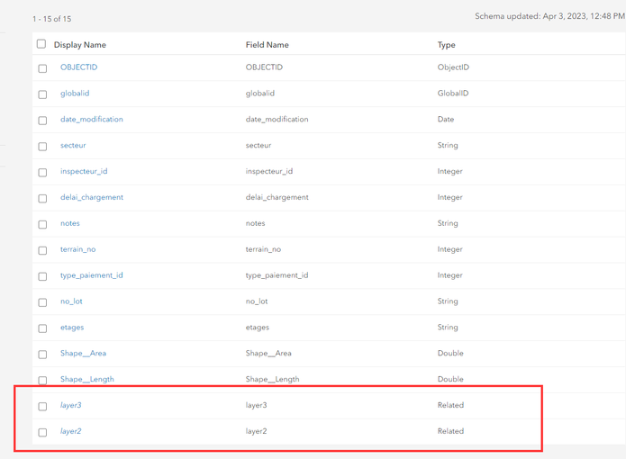

Online result showing relationship names and not display name:

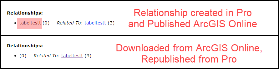

If instead I publish directly from ArcGIS Pro with "share as web layer", then I do get the display name, but the relationship name is also the display name (which I guess is ok?):
When publishing directly from ArcGIS Pro, a Service definition is also created on AGOL with the same name as the newly created hosted feature layer (while when zipping the GDB and uploading it manually, there is no service definition. Could this be the cause?
