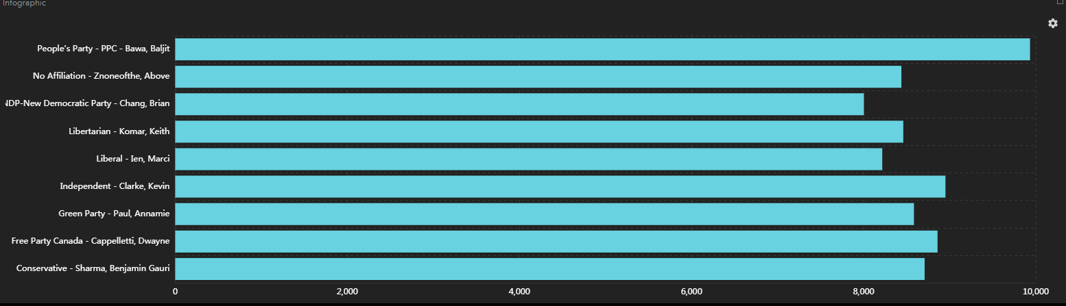

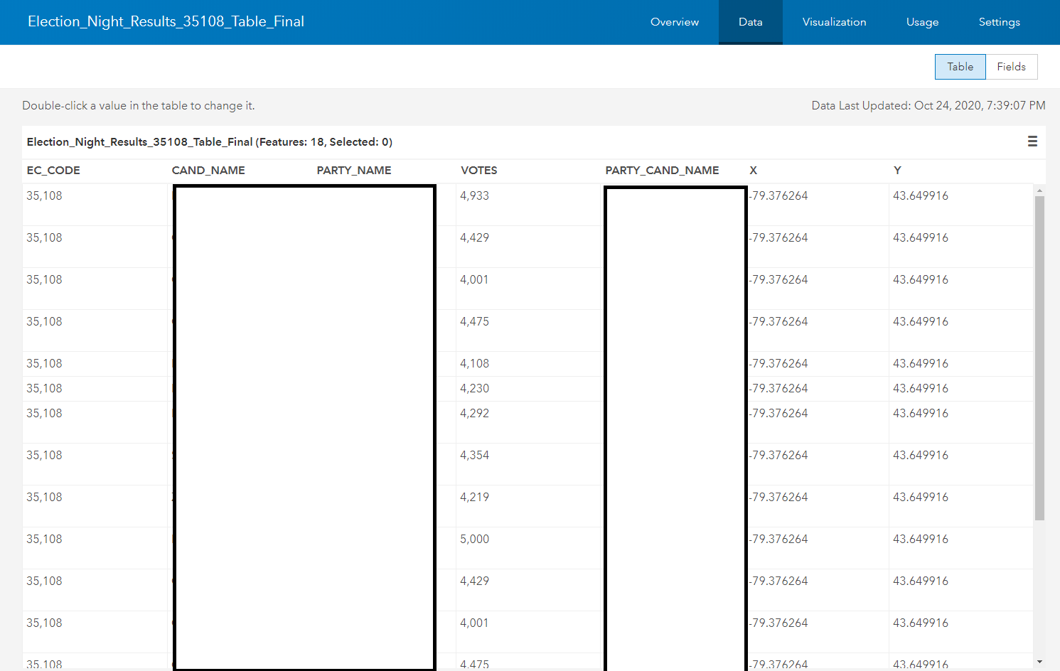

I created a Web Map with two different infographics displaying the number of votes per political party/candidate. These numbers will need to be updated every ten minutes or so, and I tested out whether "Update Data"/"Append data to layer" would properly update the data inside the infographics. It did something very strange - instead of displaying the proper numbers in the updated table, it multiplied the values! I have appended the table multiple times now but, it keeps multiplying the values - in this instance, multiplying the number of votes.

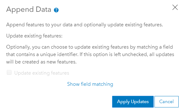

I want to be able to click the box "Update existing features" but it is grayed out. I have unique IDs in my Excel sheet but for some reason, it does not show in the Feature Layer table.

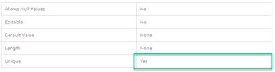

You will also need to make sure that the field that is unique in your spreadsheet is designated as unique from the Data tab of the hosted feature layer: Manage hosted feature layers—ArcGIS Online Help | Documentation
If Sync is enabled, update existing features will also be grayed out. You can disable Sync from the Settings tab of your layer.
Without the update existing features box checked, it makes sense that your chart counts that sort on attributes are increasing each time. This is because each feature in the spreadsheet will be treated as a new feature and added to the count.

I am experiencing similar issues as those described by Jenny. I am trying to update (not just append) several hosted feature layers in ArcGIS Online but the update existing features checkbox is greyed out in all the layers I have tested. This is despite following this guidance and ensuring that Sync is disabled, that there is a unique identifier present in both the feature layer and the dataset being used for the updated. I am struggling to work out what is preventing the update existing features option from being accessible. Do you have any suggestions? Furthermore, is there an alternative tool in ArcGIS Pro that allows for update, rather than append?

Even if the values are unique, ArcGIS Online has to know they are unique. In Data > Fields > choose a field > does it show as unique?

Yes the fields show as unique as you demonstrate.

I have just created a very simple point layer in ArcGIS Pro and uploaded it to ArcGIS Online to test the Append/Overwrite functionality. After setting a field as UniqueID, when I upload a slightly edited csv, it does give me the option to Update existing features, but the only field from the ArcGIS Online feature layer that it picks up as unique to match to the csv is the OBJECTID. This is despite another field being set as unique. Furthermore it appears to struggle to match numeric (integer) entries from the csv. If I try running the update using OBJECTID as the unique identifier (as it won't let me select any others), I get the following error: "Object reference not set to an instance of an object.".
I have also tried running the update with a text (string) field as the unique identifier on this test dataset, but this returns the same error as above.
