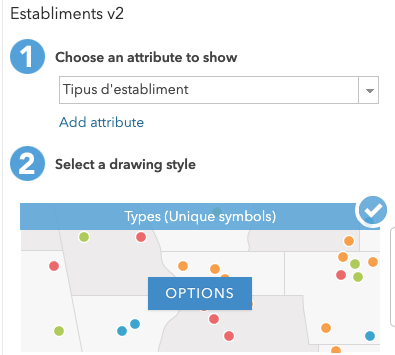

Using this layer I'm trying to set transparency based on an attribute value. I have chosen to define the style based on an String value called "Tipus d'establiments" and using "Unique symbols":

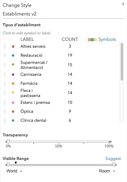

But then, I can not set the transparency based on another attribute:
I guess it is because I don't have any numerical attribute on that layer, but I was expecting to be able to use an Arcade expression to define that numerical value, isn't that possible?.

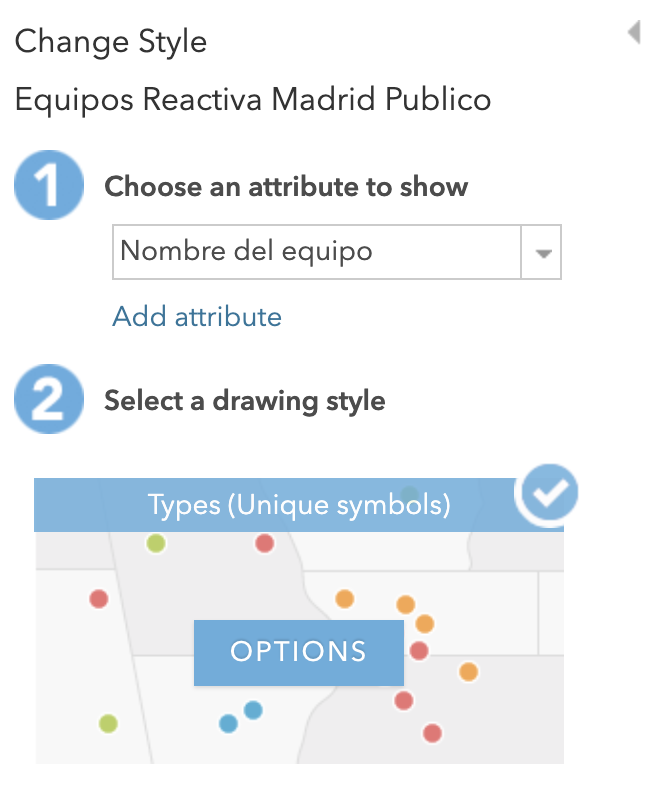

I have tried a different layer using in this case a different field (but also a String field)

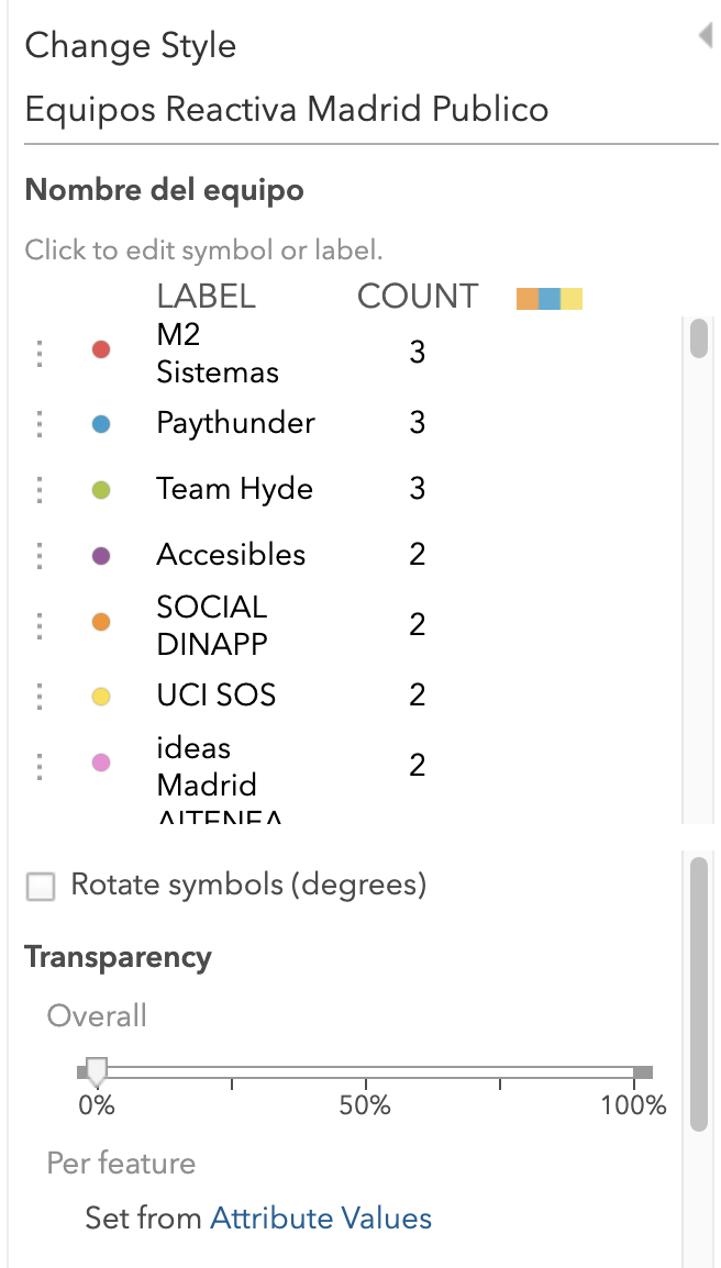

And this time I have noticed that I can set the transparency based on another value:

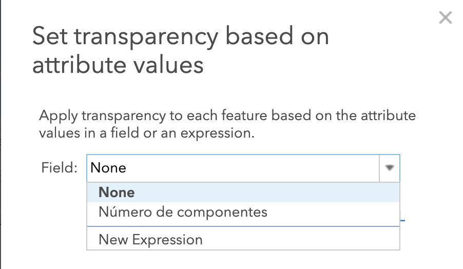

When I have clicked that option this modal shows up:
In this case, this layer has "Número de componentes" which is an Integer value, and I guess that's the condition the web interface is checking in order to show the "Set from Attribute Value" or not.

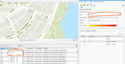

Hi Xander - I realize this is from ages ago, but these other threads around Arcade and symbology today got me reconnected here...  For this case of wanting to drive graduated symbology from a non-numeric field, it looks like that is now possible.  As I know you're very capable with Arcade😉‌‌, I'm sure it wasn't at the time you posted this, so I have to assume it changed at some point since then.  https://pro.arcgis.com/en/pro-app/2.6/help/mapping/layer-properties/graduated-symbols.htm
"Graduated symbols can be based on an attribute field in the dataset, or you can write an Arcade expression on which to generate numeric values to symbolize."
Below I'm using graduated colors on the user_id field which is a TEXT field.  Is this what you were looking for?
