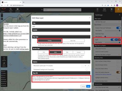

In iHunter, we can add custom layers by entering a service URL. For example, I can successfully add this WMS URL to iHunter:
https://maps.geogratis.gc.ca/wms/CBMT?service=wms&version=1.3.0&request=GetCapabilities
That GeoGratis WMS URL works as a quick test; the tiles show up in the map as expected. But what I really want is to do is add a custom raster map to iHunter. This is the map: Ontario Geological Survey Map 2499 Marble Lake (page 3).
