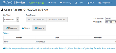

I have no experience with it other than the Demo, but there's always ArcGIS Monitor, too.
It seems to be able to return per-user request counts for sepcific content reports.. But I'm pretty sure it's only for Enterprise, not AGOL. These data are clearly coming from somewhere, but I would guess that without direct access to the machine hosting the server instance, you probably wouldn't be able to get at it, or at least, not very easily.
