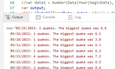

This is an example of what I was thinking of. I'm using the recent earthquakes data to summarize how many earthquakes happened each day and the largest quake of the day. I get the first and last days of the dataset and set the beginning date without the time. Using a While loop, I cycle through the days, adding one day to the existing day, filtering the data by that time span, ordering that filtered data, and reporting the number of quakes and the largest quake for the day. Then I add a day and go through the loop again. The loop breaks when I've gone past the last day of the data.
The one thing I haven't quite worked out is the time zone issue, where it's starting the day at 8 pm local time.
// Fetches features from a public portal item
var fs = FeatureSetByPortalItem(Portal("https://www.arcgis.com"),"9e2f2b544c954fda9cd13b7f3e6eebce", 0, ["*"], false);
var sortedFS = OrderBy(fs, 'eventTime DESC');
var endDate = First(sortedFS)['eventTime'];
var reverseSortedFS = OrderBy(fs, 'eventTime ASC');
var beginDate = First(reverseSortedFS)['eventTime'];
var date1 = Date(Year(beginDate), Month(beginDate), Day(beginDate));
var output;
while (DateDiff(endDate, date1, 'day') > 0) {
  var date2 = Text(DateAdd(date1, 1, 'day'), "MM/DD/YYYY")
  var filteredFS = Filter(fs, `eventTime BETWEEN '${Text(date1, "MM/DD/YYYY")}' and '${date2}'`);
  var sortedFilteredFS = OrderBy(filteredFS, 'mag DESC');
  if (Count(filteredFS) > 0) output += (`${Text(date1, "MM/DD/YYYY")}: ${Count(filteredFS)} quakes. The biggest quake was ${Round(First(sortedFilteredFS)['mag'],1)}
  date1 = DateAdd(date1, 1, 'day')
return output;

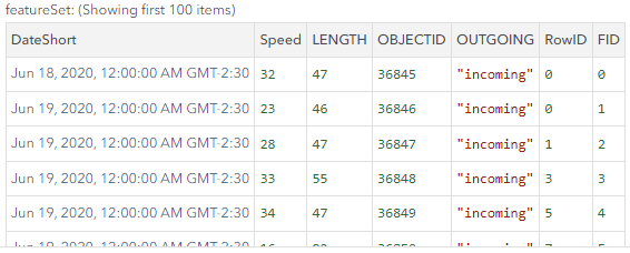

Here is my code and the results I'm getting. The numbering (rowID) still isn't numbering correctly nor is it sorted by speed.
//related table
var TrafficTable = FeatureSetByName($map, "Traffic Cameras - TrafficCounts", ["DATE", 'GUID', 'LENGTH', 'OBJECTID', 'OUTGOING', 'SPEED'])
//Fields in feature to filter the related table by
var GID = $feature.GlobalID
var ST = DateAdd($feature.StartDateTime, +2.5, 'hours')
var ET = DateADD($feature.EndDateTime, +2.5, 'hours')
//Filter the related table on the Global IDs & start and end times
var fil = Filter(TrafficTable, 'GUID = @GID')
var FilTime = Filter(fil, 'DATE >= @ST and DATE<= @ET')
// Convert datetime to date for table and creates the main feature set to display in pop-up
var new_fs = {
    geometryType: "",
    fields: [
        {name: "DateShort", type: "esriFieldTypeDate"},
        {name: "Speed", type: "esriFieldTypeInteger"},
        {name: "LENGTH", type: "esriFieldTypeInteger"},
        {name: "OBJECTID", type: "esriFieldTypeObjectID"},
        {name: "OUTGOING", type: "esriFieldTypeString"},
        {name: "RowID", type: "esriFieldTypeInteger"},
    features: []
//used for unique numbers in RowID
var rowCount = 0
//for loop to add to the new feature set (new_fs)
for(var f in FilTime) {
    var d = f.DATE
    var date_short = Number(Date(Year(d), Month(d), Day(d)))
    var U = Filter(FilTime, "DATE < @d")
    var O = OrderBy(U, "SPEED ASC")
    for (var T in O){
        rowCount += 1
    Push(new_fs.features, {attributes: {DateShort: date_short, Length: f.LENGTH, OBJECTID: f.OBJECTID, OUTGOING:f.OUTGOING, Speed: f.SPEED, RowID: rowCount}})
//Data as a feature set
var fs_all = FeatureSet(Text(new_fs))
return OrderBy(fs_all, "RowID ASC")
var output;
return output;

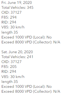

RobynSnookCCB
Thank you, I've made your corrections but they code isn't updating the variables placed in the if statement in line 20. It keeps giving the same ones from the first date. Any suggestions? I assume its broken somewhere in the for or while loop, not positive how to correct it.
Thank you.
//while loop to run through and filter out the data by date & order by speed
while (DateDiff(endDate, date1, 'days') > 0) {
  var date2 = DateAdd(date1, 1, 'days')
  var sortedFilteredFS = OrderBy(Filter(FilTime, `DATE BETWEEN '${date1}' AND '${date2}'`), 'SPEED ASC')
  //Total count of vehciles by day
  var TCount = Count(sortedfilteredFS)
  //the 85th ID number per day
  var F85_ID = Round((TCount*0.85)+0.5,0)
  //loops through the data that is separated (filtered) by  date and sorted by speed
  for (var f in sortedFilteredFS){
    var S = f.SPEED
    //applies unique numbering by date and sorted by speed
    if(S > 0){
      rowCount += 1
       //KEEPS GIVING THE SAME VALUE TO ALL DATES
    if(rowCount == F85_ID){
      var v85 = f.SPEED;
      var L = f.LENGTH;
      var OID = f.objectID;
      var RID = rowCount;
      break
   //text info
  if (TCount > 0)
  output += `${Text(date1, 'ddd. MMMM DD, Y')}
  Total Vehicles: ${TCount}
  OID: ${OID}
  F85: ${F85_ID}
  RID: ${RID}
  V85: ${v85} km/h
  length ${L}
  Exceed 1000 VPD (Local): ${IIf(Class == 0 && TCount >= 1000, 'Yes', IIF(Class == 1, 'N/A','No'))}
  Exceed 8000 VPD (Collector): ${IIf(TCount >= 8000 && Class == 1, 'Yes', IIF(Class == 0, 'N/A', 'No'))}` + TextFormatting.NewLine + TextFormatting.NewLine
return output
KenBuja
MVP Esteemed Contributor
You're calculating F85_ID for the filtered records for each day, but you never reset rowCount to zero for each day.
