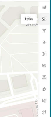

If styling is supported for the layer type you are using, you will see the styles button on the light toolbar in Map Viewer. If styling is not supported for that type of layer, it will not be visible.
