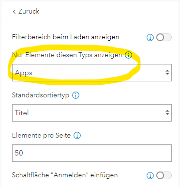

Unfortunately the filter options here are not sufficient for our needs. An added function to show elements filtered by tags would be awesome.
My question: Is there a plan to include a tag filter function in the app configuration in the future, or a way to achieve this right now?
Our use case: We use the Gallery Instant App in the Hub to display all the apps and items (Dashboards, Instant Apps, uploaded PDFs, linked content etc.) that our people can work with on their desktop computers, separated by team (rangers, education, etc.). For each team I created a user group (ranger, education, etc.) for specific access. Let's look at the rangers:
  • If I show them all the content by group (ranger) they can see absolutely everything - including e.g. seeing every feature layer, and opening every map in map viewer - that has been shared with them.
  • If I show them just the Apps they can see no linked content or PDF, but they see every Survey 123 item, even those that they can't work with (because it's not shared to send in surveys from the browser).
