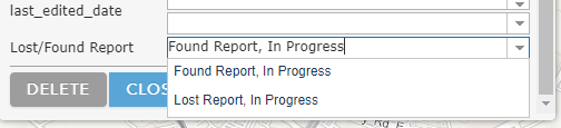

In ArcMap, I can edit the feature template to show only 'In Progress' projects in Create Feature. When I published it to ArcGIS Online, in the edit pane, it shows all the types 'closed' and 'in progress'. When I delete the 'Closed' ones in the Manage template, these 'Closed' types are deleted from edit dialog box from:
I am trying to create a web app for editing. When users add new features, they will only have the choices of creating 'In progress' types and later they will edit the these feature to 'Closed.'

During editing, adding new feature, I will like to have only 2 options for the users to select:
- Lost, In Progress
- Found, In Progress
And when editing the existing feature,they have the options all the 4 options:
- Lost, In Progress
- Lost, Closed
- Found, Closed
I also used Subtype so that the other 2 fields are being updated using the Default Value.
