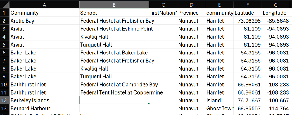

Thanks for this, Laura! I do have a different version of each of my spreadsheets that is the base data with no delimiter, so I can create a new CSV that includes a new row of data for each relationship and see how it goes. This will generate something that looks like this:Many_to_many.png
My hesitation to do this in the beginning was that ArcGIS would see each entry as a unique value and create duplicate locations. If it does work it will save me a lot of time having to import a high volume of CSVs to generate layers of one-to-one relationships. I will report back once I've done more testing.
