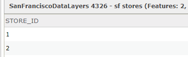

I have a layer with two stores, and they have a unique ID field called STORE_ID:

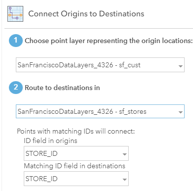

Then I set up and run the tool:
It runs successfully and calculates a route between each customer and their assigned store.  (The example is made somewhat confusing by the fact that the ID fields have the same name, but they don't have to.)
So, the ID field in origins need not be unique, but the ID field in destinations does.
