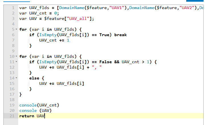

I have 5 text fields, each holding a name. In AGOL I've created a new field that should hold all respective field values in a string (I used 2 for loops to count the number of non-empty fields; if there's just 1 populated field, I don't need a comma separator). Testing my Arcade expression in the console was successful, the output is correct, but it simply won't write to my newly created field, although it says calculating fields > committing > inserting when confirming my Arcade expression window with OK. It just stays empty.
Here's my code and my console output:
How do I write my output into my newly created field on which I applied the field calculation?

EkremCanli2
I've tried your code, it worked in the Arcade Calculator, it again said calculating fields > committing > inserting, but the fields still stay empty. Am I missing a command to actually write the output of the console into the fields when using the calculate fields tool on AGOL? Whatever I do, it's always empty:

EkremCanli2
Hi Xander Bakker‌...I think it has to do with the fields having domains. When I just return 'test', my new, empty field is correctly populated with the string test. When I run 'return DomainName($feature,"UAV1")' it shows the correct result below in the results, but when I confirm with OK to run the arcade calculator, my field remains empty... Any further idea?

Hi Ekrem Canli ,
Thanks for testing this. To me this sound as something that should be reported to support. You should be able to use the DomainName function in the expression. One could do an additional test using the actual domain code of the feature and using the Domain function to see if you can extract the name from that domain, but I don't think that has a lot of potential. Please report the issue to support to have this fixed.
