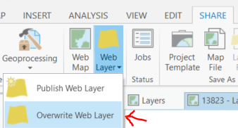

I am trying to republish a feature service to ArcGIS Online​ by choosing overwrite through ArcGIS Pro

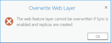

Here is the error message I get:
It says "Overwrite Web Layer
The web feature layer cannot be overwritten if Sync is enabled and replicas are created"
I checked and Sync is not enabled
(checked off)
And I do not have replicas, though I can create replicas in my REST services page:
I am not sure what to do besides delete my service and try again. I saw this thread: AGOL replica removal
But, he found replicas and deleted them.  Has anyone seen this before?

Hi Adrian,
For your specific issue, this was related to https only being disabled on your organization while you were still signed into ArcGIS Pro. Try signing out of ArcGIS Online and then back into ArcGIS Online to see if this clears up the overwrite issue. Support Services is going to look into logging the issue for you, so hopefully you can update this post when you have the defect.

Hi Adrian,
-Kelly
AdrianWelsh
MVP Honored Contributor
Hi Kelly,
That was an easy fix! Thanks for suggesting that. I will let you know about support services and a ticket being logged.
