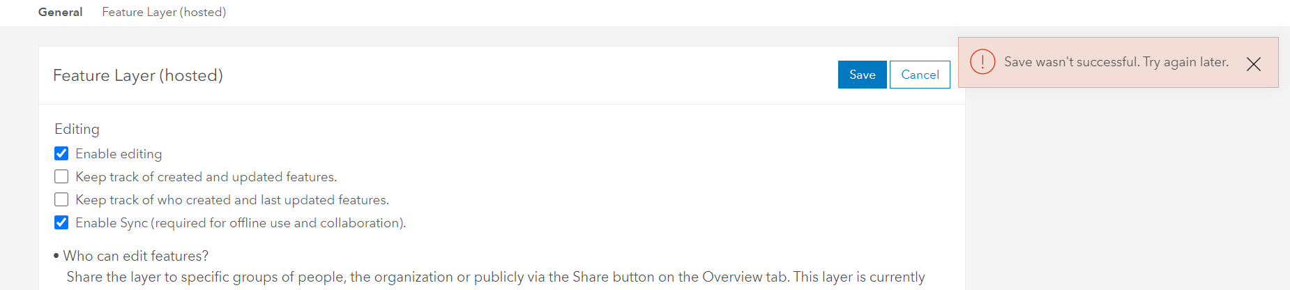

I'm getting an error message when trying to Enable Sync for my feature layers:
Save wasn't successful. Try again later.
I don't have any creator/editor fields in my data tables. Not sure what's preventing this.
I published two feature layers (part of a feature dataset) in a webmap through ArcGIS Pro.
