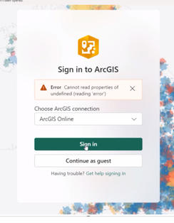

It is occurring with us as well we receiving following error after clicking on Sign in option.
We tried the workflows mentioned in the above post, but the issue persists. In some of the above post, it is recommended to turn-off the "Power BI Desktop infrastructure update" preview feature, but we are not able to locate the setting at our end. We are currently using Power BI desktop version 2.131.1126.
Any help would be highly appreciated.

I am also at 2.131.1126. I just opened a new report and am seeing the same error you show. In my case, the error happens when attempting to login to my ArcGIS Enterprise portal. If I switch to the ArcGIS Online login, I get in. I'm just thinking out loud here, but I wonder if the issue is associated with: Problem: Impact of Google Chrome and Microsoft Edge 127 Updates on ArcGIS Enterprise (esri.com)
Those Chrome and Edge updates are happening now, if I understand correctly. I applied the patches to my Enterprise server a couple of weeks ago and have not noticed any issues until today. Of course, I'm just speculating and there might be no relation.
MarkWestergaard
@Tribhuwan I followed the updated instructions for PBI Desktop at Clear the browser's local storage—ArcGIS for Microsoft 365 | Documentation and my issue cleared.
