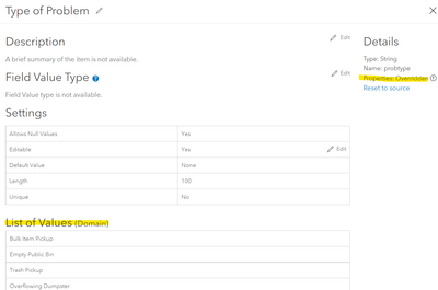

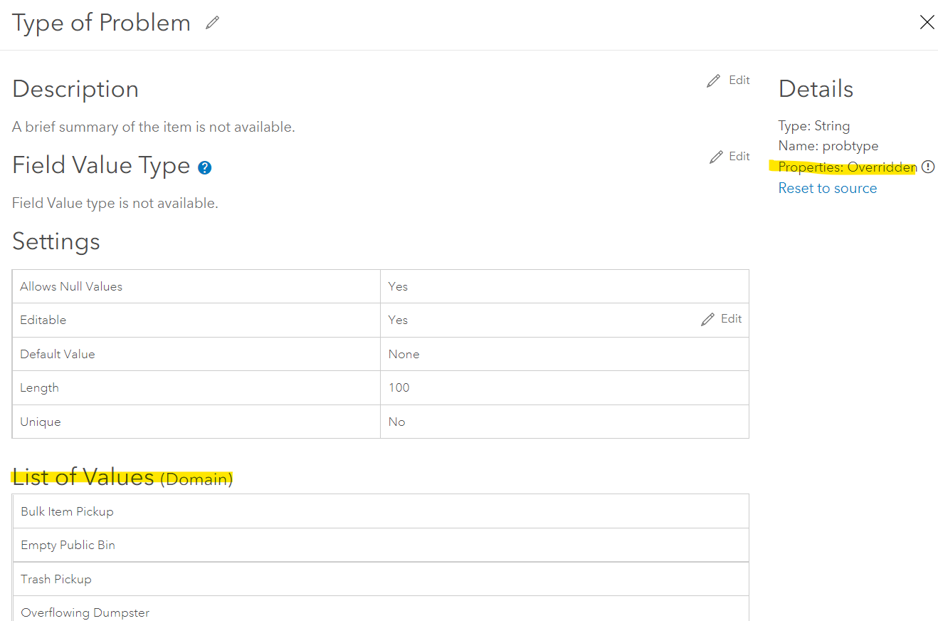

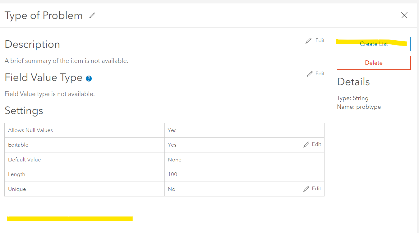

I know it can be done because I saw it in a hosted feature layer view of an arcgis solutions, look:
this is the hosted feature layer:
and this is one of the many hosted feature layer view:
