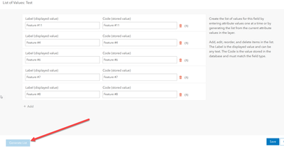

@MikeFigurayare you going to be regularly changing and updating the domains? If you are wanting to easily import a large set of domains from a CSV I think you can do this fairly easily without manually copy/paste.
  1. With your CSV containing the domain values for the field you want to match to, navigate to the item details page of your hosted layer
  2. Click Update data, then Add features. You should be able to upload the file
  3. Ensure that the filed you want the domains in is matched correctly (others can be unmatched)
  4. Then If you go into the settings tab on the item details page of the host feature layer, you should be able to navigate to the field, click Create list and then Generate list from all the newly imported values.
  5. If you want to remove the data you just imported, for can delete the features but still keep the domains list
Does that make sense?
