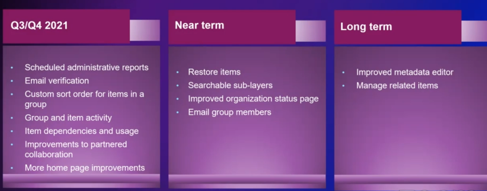

Hi, not the best answer, but they talked about this coming in the "The Road Ahead" session at Esri UC this year. Listed under "Near term" for the ability to restore items... I can't recall but I believe it applied to maps/apps.
https://uc2021.esri.com/live-stream/19775053/ArcGIS-Online-The-Road-Ahead

Hi @DougBrowning , we posted replies at the same time, I apologize I did not see yours at first. I think what was described at the UC is similar to the "Recycle bin" feature you mentioned, so perhaps this is not a true failover type system. Appreciate all the details you offered up and am curious to see any further posts.
