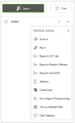

Hello Roberto,
I assume you are using the Select widget.
Click Create Layer to create a new graphic layer on the map. You can turn it on and off in the Layer List widget.
Please check the below link for more details.
Use the Select Widget
Let me know if your issue is different.
