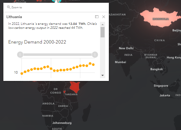

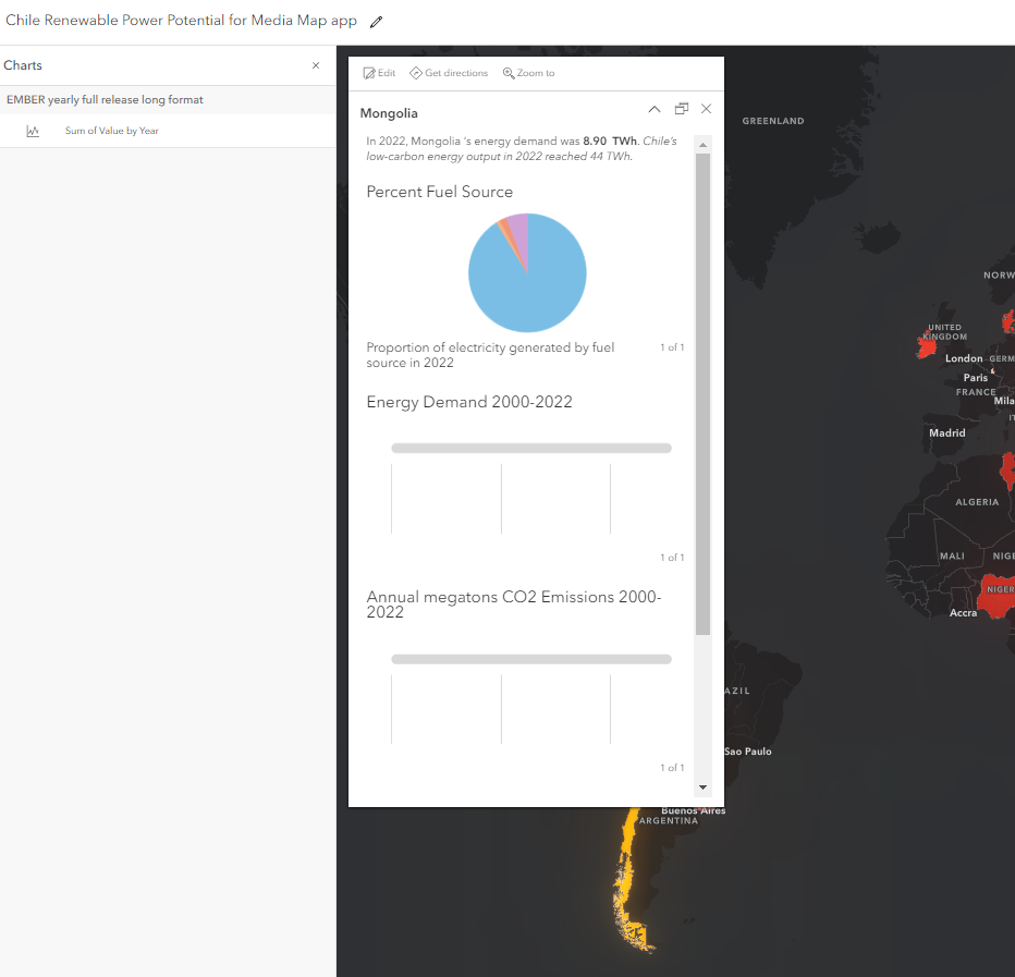

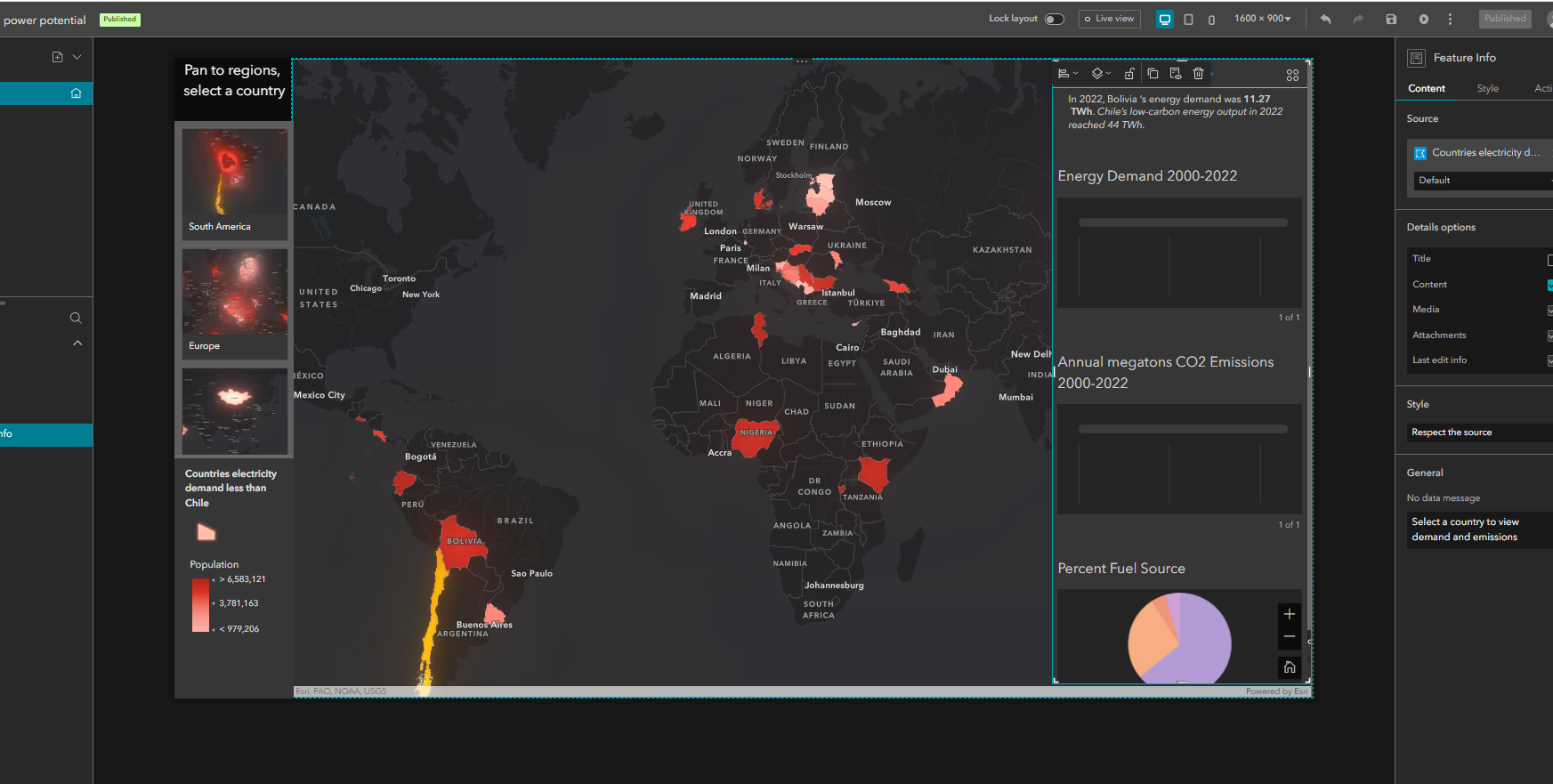

Here's a screenshot of how one of the charts render in story map and how it fails to render even in the webmap! Note, for some reason the pie chart uses different colors now. Totally at a loss.
StoryMap view:
WebMap View:
Experience view:
