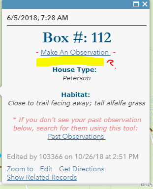

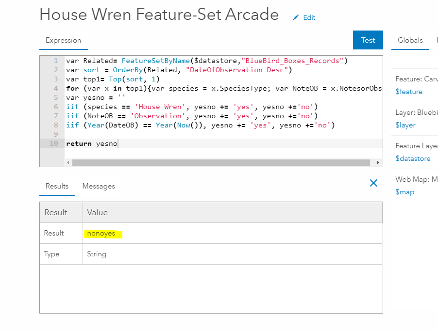

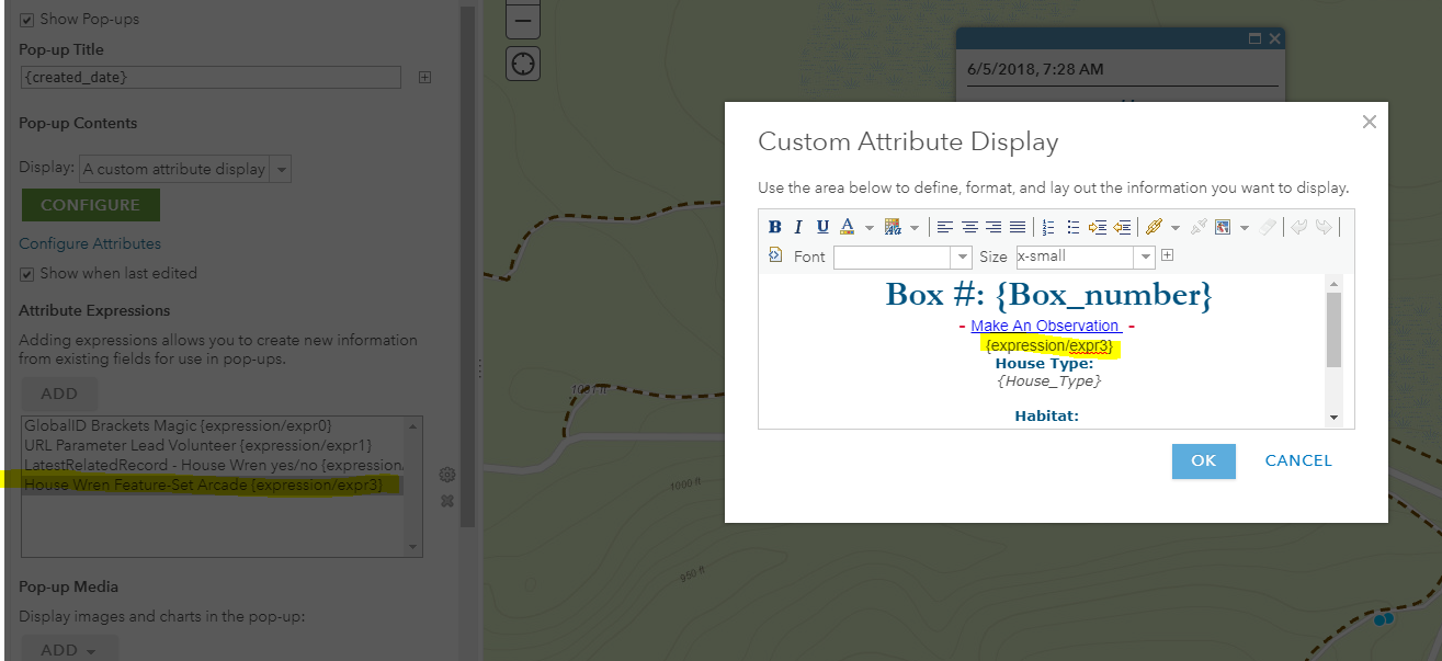

We recently constructed an Arcade expression using Feature-Sets. The arcade expression validates but does not display in the popup. It's a simple text string that should display. Even if we change the return to an arbitrary word like "test" it still does not display in the popup. Please see images below. Expression is in text form at the bottom of the post.
Any other arcade expressions work fine in this web map and popup.
Explanation of the expression:
We're displaying a string of text that falls under three parameters NotesOrObservation is Observation, SpeciesType is House Wren, and DateofObservation is Current Year. Since "AND" statements don't seem to be a supported Arcade function we used the below.
-  Feature-Set is looking at the related table in the map
-  Sorting by "DateOfObservation" date descending
-  If parameter is met "Yes" is returned
- Return is a concatenation of three parameters
      example) If all three parameters are Yes then "yesyesyes" is returned
Arcade Expression and Result:
Expression in popup configuration:
Popup Blank Return:
Expression:
var Related= FeatureSetByName($datastore,"BlueBird_Boxes_Records")
var sort = OrderBy(Related, "DateOfObservation Desc")
var top1= Top(sort, 1)
for (var x in top1){var species = x.SpeciesType; var NoteOB = x.NotesorObservation;var DateOB = x.DateOfObservation}
var yesno = ''
iif (species == 'House Wren', yesno += 'yes', yesno +='no')
iif (NoteOB == 'Observation', yesno += 'yes', yesno +='no')
iif (Year(DateOB) == Year(Now()), yesno += 'yes', yesno +='no')
return yesno

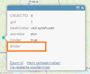

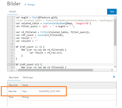

I can see that it is a bit old discussion but I have the same problem. I have written Arcade expression which validates in console and I can see a result, but the field is empty in pop-up.
What the script does is getting an url attribute from related table. As the relation is 1:M, I want to get all the urls and display them in separate fields. That's why I create a list and then refer to lists items.
I attach pictures and the code. I would really appreciate any help.
