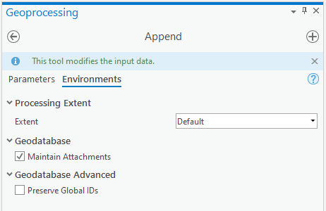

Hello,
I am having trouble updating my hosted feature layer on AGOL. I am trying to use the Append tool in ArcPro to add recent data and I want to keep the attachments.  My source data is in a fgdb. The feature class I am working with has 2,814 point features and there are 5,688 pictures in the related attachment table.  I am careful to make sure my fields match and I have the "Maintain Attachments" checkbox selected.  I have successfully done this a number of times in the past but never with this many attachments.  When i run the tool it runs through to completion with ought giving an error.  The feature points get added but not the attachments.  Is there some magic limit in ArcPro or AGOl that is causing this to fail or this there a better way to do this???  I am using ArcPro 2.8.0.
Thanks,
Josh

@DavidRichey You shouldn't run into this issue if you have downloaded both datasets and appending features from one to another in Pro. As long as the "Maintain attachments" option is enabled in the environment settings.

@DavidRichey Also, ArcGIS Pro 2.9 is available for upgrade now so you can append data from a feature layer/table to a hosted feature layer on ArcGIS Online while maintaining attachments.
However, if you have related data where relationships are base on GlobalID field, the offline workflow (download, append, overwrite) might be a better option. Because when appending features to a hosted layer, appended features will have new GlobalIDs, the related records will be disconnected from their parent features.

Hi @jacbro I tested a few tools in ArcGIS Pro 3.0.3 and I can confirm that attachments were maintained when I had "Maintain Attachments" enabled in the environment settings. Can you please provide more details about your workflow and the tools that you are seeing this issue with?
