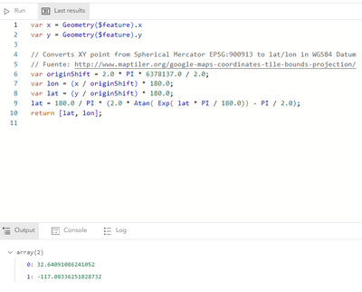

This is possible with a bit of arcade, would be great to have a ToLatitude(geometry($feature).x) and ToLongitude(geometry($feature).y)
Arcade Functionality from XanderBakker
var x = Geometry($feature).x
var y = Geometry($feature).y
// Converts XY point from Spherical Mercator EPSG:900913 to lat/lon in WGS84 Datum
var originShift = 2.0 * PI * 6378137.0 / 2.0;
var lon = (x / originShift) * 180.0;
var lat = (y / originShift) * 180.0;
lat = 180.0 / PI * (2.0 * Atan( Exp( lat * PI / 180.0)) - PI / 2.0);
return [lat, lon];
