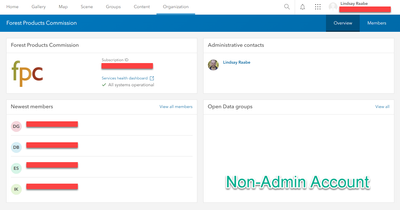

In ArcGIS Online, I've been in the process of adding bulk users to a new organization, but it's been a bit frustrating trying to cross check at-a-glance who has accepted invitations and who hasn't with a list maintained in a spreadsheet (from another organization).
I then discovered, that if I log in with a non-Administrator account, there is this handy little window showing the newest members to join!
IDEA: Add the same window to the Administrator view of the Organization page, or add a "joined date" option to the sorting list on the Members page.

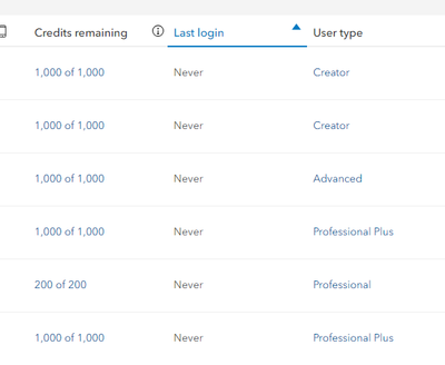

AndreasHall
If you sort the member list on Last login, and order from oldest date to newest, members who have been added but not yet logged in, will be seen as Never. Does this work for your purposes?
LindsayRaabe_FPCWA
Not really - I find that plenty of users have joined by clicking on a link to the org (e.g. from our intranet) and not through the invitation. Then they get added without their customised group settings, roles, etc. So then I need to update them and they don't have a "Never" value in the Last Login date - just mixed in with everyone else.
