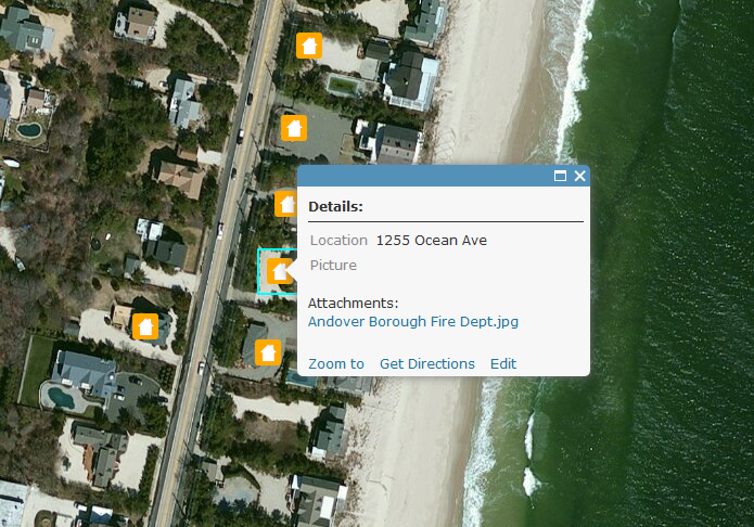

Here is a screen shot on how attachments display within a web map popup by default:

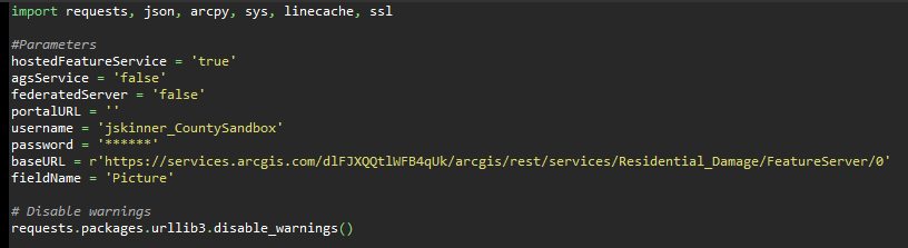

1.  Add a TEXT/STRING field (i.e. "Picture")  to the feature service that can support a large amount of characters (i.e. 1,000).
2.  Execute the attached GP tool.

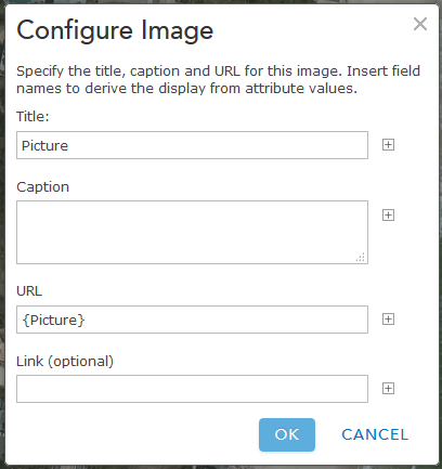

3.  Configure the pop-up to Show Images.  Ex:

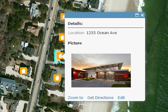

The image will now display directly in the popup.  Ex:
