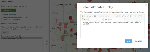

RustyCook
Hello,
I tried looking for blogs that had similar questions and this seemed to be the closest. I have a feature layer hosted on enterprise and one of the attributes ("content") contains a link to a pdf document. On the web map popup configuration I threw this HTML in:
<embed src="{content}" type="application/pdf" width="100%" height="800px"> </embed>
Initially it looks like it worked (see below), however once I save the map and then try to open it again the embed code is removed from my custom display.
I tired using other HTML tags as well such as <iframe> and <object> however the same thing occurred.
Thanks!

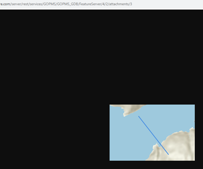

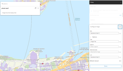

HI everyone,
I can follow to create Arcade script and get the URL. Unfortunately, nothing to display in popup window. Anything I missed?
I can query and concatenate the URL
URL is valid and lead to an image
However, nothing shows in Popup
End up, I found that the Attachments($feature) return nothing. The Feature Service, Web Map, all related items are shared as Public.

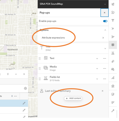

Solution:
  1. Arcade expressions in the pop-up configuration to (re)construct urls for attachements
  2. Add content feature in the pop up configuration (text/image) to create the html object using the arcade expression as my url (see photo – I am a novice and can never find anything!)
Detailed steps:
  1. Step 1 – create attribute expressions in Options section of the pop up configuration pane in order to construct URLs – note: I used the blog for this – it follows the same logic. The base url in Part 1 is the hosted feature service. I obtained it by opening an attachment and copying everything up to the “/0/”
Expression 1: (first attachment) – note: I am not sure if I need the first line, but the blog post had it, so I included it here. Replace my “base” URL in line 2 with yours.
  1. var Has attachments = Count(Attachments($feature))
  2. var Part1 = “https://services.arcgis.com/ZAA95z0SYTDJP9yw/arcgis/rest/services/survey123_14108d4dcaeb48a0a01d5d28... +
  3. $feature.objectid + “/attachments/”
  4. var Part2 =  First(Attachments($feature)).ID
  5. return Part1 + Part2

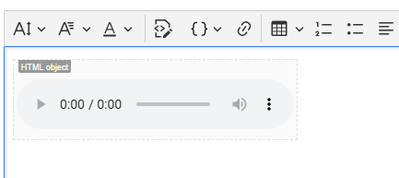

Step 2: Create html object to play audio – note - in my case, the first attachment is always audio:
  • Add “text” content
  • Select “source” environment (replace expression with the relevant expression for your audio url: mine is: <p><audio controls=""><source src="{expression/expr2}" type="audio/mpeg"></audio></p>
  • Tip1: I couldn’t get the UI to add access fields from within the source code editor, so I added it first in the regular text environment and then pasted it into my code
  • Tip2: When I closed the source environment, it looks like a non-working object – that was misleading – check it with an actual popup to see if it worked - see image that almost made me cry:
  • and then I tested in an actual pop up - HOORAY
Step 3: Add an image element – note: in my case, the image is always the second attachment
  •  Same basic method but simpler: Added content and selected “image.”
  • In the URL field, I entered the expression I had created: {expression/expr3}
