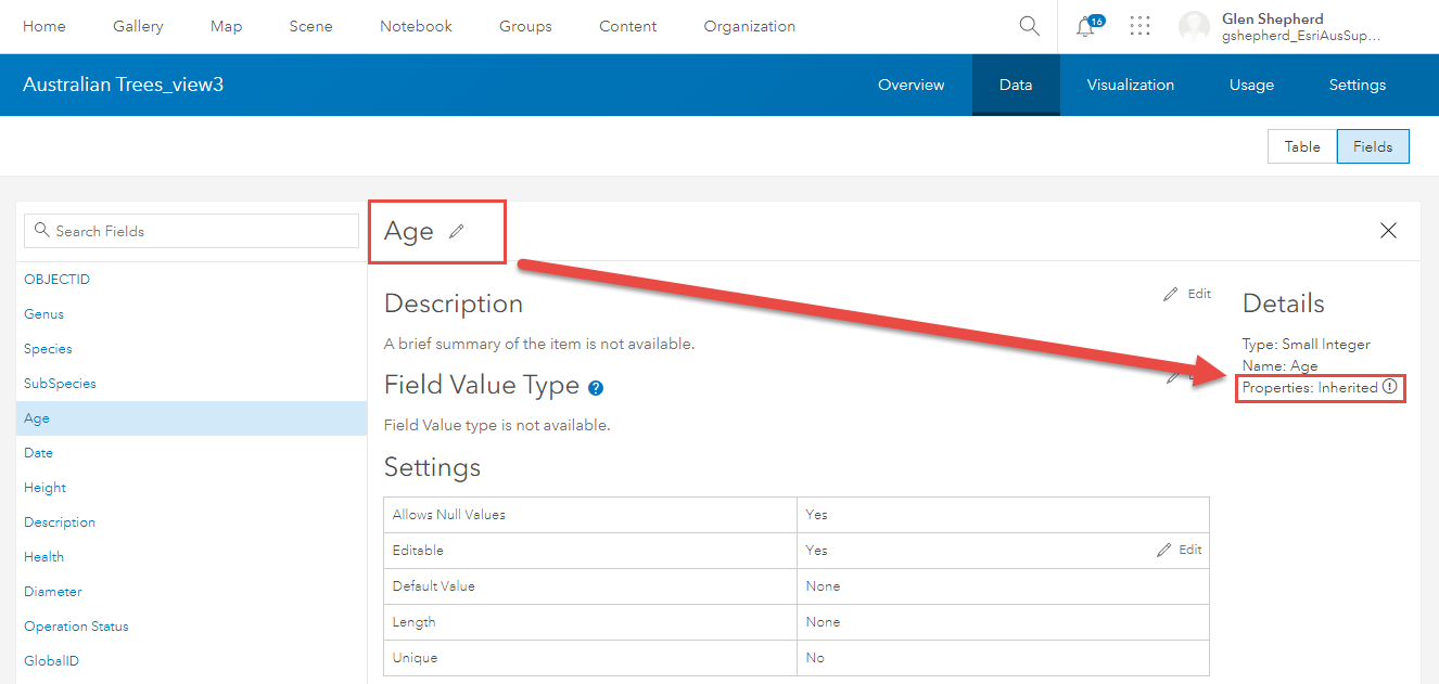

    By default, changes made to the parent layer are "Inherited" by the view layer. Properties: Inherited
  • However, if a change is made to the field name, the view layer's update property becomes "Overridden" and changes to the parent hosted feature layer are not reflected. Properties: Overridden
  • The connection and inheritance can be re-established by clicking on the "Reset to source" button (pictured above) which will revert any changes made to the field, back to that of the parent Feature Layer. The user should check all other fields to ensure this hasn't happened elsewhere.

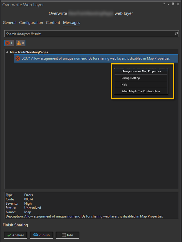

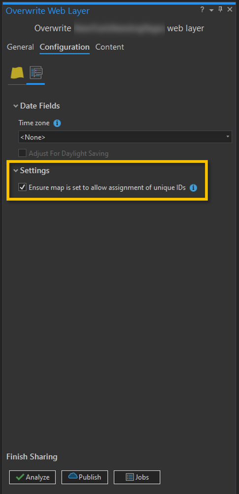

I've submitted a bug and enhancement for this behaviour:
  • ENH-000141026 - "ArcGIS Online: add ability for the 'Update Data' method of appending to add additional feature classes to a grouped hosted feature layer."
  • BUG-000141027 - "ArcGIS Online: If the "Overwrite" method is used to add new feature classes to an existing hosted feature layer, any pre-configured view layers will not inherit the newly grouped feature classes"
Hopefully future development efforts can address this behaviour.

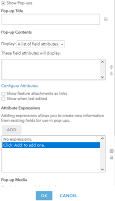

2. Do you mean you're now unable to use the "configure popup" option as described here: https://support.esri.com/en/technical-article/000022958 ?

2. Yes, I mean that I am unable to "configure pop-up" at all for the View layers that went through the workflow I described in my initial post (point 2). This is what I see now - it basically locks up the View "Visualization" page and I need to refresh or change pages to 'unlock' it again. If I click "OK" or "Cancel" at the bottom, nothing happens.

I then opened ArcGIS Pro (2.9) again, added a couple more fields, added some more features and carried out an Overwrite.
The existing view layer fields still maintain the "inherited" property, however it has not inherited any of the new fields added to the parent and all features are missing, with "Data Error" under the attribute table.
Perhaps it only works if you overwrite with a downloaded FGDB of the parent rather than the original feature class? Strange one.

Hi,
I wanted to follow up on my post from yesterday, as we were able to pinpoint the issue. And I was reminded that we ran into this a few weeks ago when overwriting a Feature Layer that had a public View that became invalid.
Someone can correct me, but it appears that the issue is the assignment of unique IDs to layers being published, which might be different than what the View layer is looking for from the original Feature Layer.
In both cases, our issue was solved from within the Configuration Parameters of the Overwrite Web Layer tool before overwriting/republishing, by unchecking the box to Ensure map is set to allow assignment of unique IDs (see attached). If this is checked (which it appears to be by default), and the map properties are NOT set to allow this assignment, then you will receive an error when Analyzing before overwriting.
The error message gives you to two options to rectify the situation: General Map Properties or Change Setting. When this problem first appeared, we chose the first option ("Change General Map Properties") and checked that box so that the map and the tool were in agreement. However, I think this is what caused the unique ID issue with the View layer. So our real solution was to choose the  Change Setting option (of the Overwrite web layer tool) and uncheck the box.
We now plan to simply go to the Configuration Parameters and uncheck this each time we overwrite so as not to get the error or cause an issue with any View layers we've created.
Note that our workflows related to this issue are simple, with a single feature class being published as hosted Feature Layers with a single publicly-shared View layer. Other users will likely have more complex Feature Layers or Views that may require the assignment of Unique IDs, so this may not solve the issue for everyone.
Hope this helps!
