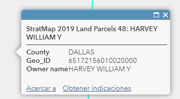

utenalarosa
@XanderBakker
I got this layer from the living atlas this is the link to the map service  https://feature.tnris.org/arcgis/rest/services/Parcels/stratmap19_land_parcels_48/MapServer/0
XanderBakker
Esri Esteemed Contributor
Hi @utenalarosa ,
Thanks for sharing the URL of the service. As I expected the "empty" fields contain a single space and therefore are not considered empty. To avoid this change your expressions to use Trim:
IIf(IsEmpty(Trim($feature["Owner_Name"])), "", "Owner Name");
utenalarosa
@XanderBakker
It still not showing the field names I invited you to the group I created.
XanderBakker
Hi @utenalarosa ,
I see what is wrong. The expressions are correct but you have to correct the HTML. In the HTML you are using "{espression/expr6}" when it has to be "{expression/expr6}". It is the same for all the other expressions that you are calling in the HTML of the pop-up.
utenalarosa
@XanderBakker
thank you so much it's because English is my second language Italian is my first language.
XanderBakker
Hi @utenalarosa ,
Don't worry the important thing is that we figured it out and it is working now!

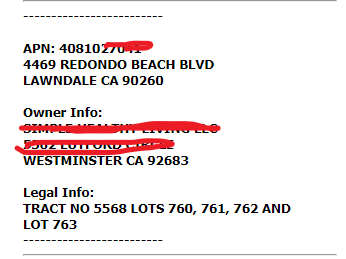

RyanTucker
Here is how I was able to hide blank fields from my popup. Maybe it will help someone.
Just a bunch of If statements that  build the popupString field by field. Not very pretty. But it works for my purposes
// Declare variable with fields to access in FeatureSet function
var assrFields = ['PARCELID', 'SA_FullAddress', 'SA_CityStateZip', 'First_Owner_Assee_Name', 'First_Owner_Name_Overflow', 'Special_Name_Legend', 'Special_Name_Assee_Name',                                                   'Second_Owner_Assee_Name', 'MA_FullAddress', 'MA_CityStateZip', 'Legal_Description_Line1', 'Legal_Description_Line2', 'Legal_Description_Line3', 'Legal_Description_Line4',
                  'Legal_Description_Line5', 'Legal_Description_Last']
// Access 'Parcels related AssessorSBF' table as a FeatureSet
var relatedrecords = (FeatureSetByRelationshipName($feature, 'AssessorSBF', assrFields, false))
// Build the pop-up string by iterating through all related features
var popupString = ''
for (var f in relatedrecords)
var linebreak = "-------------------------"
popupString += linebreak
    if (!IsEmpty(f.PARCELID)){
        var a = (TextFormatting.NewLine + TextFormatting.NewLine + "APN: " + f.PARCELID)
        popupString += a
    if (!IsEmpty(f.SA_FullAddress)){
        var a = (TextFormatting.NewLine + f.SA_FullAddress)
        popupString += a
    if (!IsEmpty(f.SA_CityStateZip)){
        var a = (TextFormatting.NewLine + f.SA_CityStateZip)
        popupString += a
    if (!IsEmpty(f.First_Owner_Assee_Name)){
        var a = (TextFormatting.NewLine + TextFormatting.NewLine + "Owner Info: " + TextFormatting.NewLine + f.First_Owner_Assee_Name)
        popupString += a
    if (!IsEmpty(f.First_Owner_Name_Overflow)){
        var a = (TextFormatting.NewLine + f.First_Owner_Name_Overflow)
        popupString += a
    if (!IsEmpty(f.Special_Name_Legend)){
        var a = (TextFormatting.NewLine + f.Special_Name_Legend)
        popupString += a
    if (!IsEmpty(f.Special_Name_Assee_Name)){
        var a = (TextFormatting.NewLine + f.Special_Name_Assee_Name)
        popupString += a
    if (!IsEmpty(f.Second_Owner_Assee_Name)){
        popupString += a
    if (!IsEmpty(f.MA_FullAddress)){
        var a = (TextFormatting.NewLine + f.MA_FullAddress)
        popupString += a
    if (!IsEmpty(f.MA_CityStateZip)){
        var a = (TextFormatting.NewLine + f.MA_CityStateZip)
        popupString += a
    if (!IsEmpty(f.Legal_Description_Line1)){
        var a = (TextFormatting.NewLine +TextFormatting.NewLine + "Legal Info: " + TextFormatting.NewLine + f.Legal_Description_Line1)
        popupString += a
    if (!IsEmpty(f.Legal_Description_Line2)){
        var a = (TextFormatting.NewLine + f.Legal_Description_Line2)
        popupString += a
    if (!IsEmpty(f.Legal_Description_Line3)){
        var a = (TextFormatting.NewLine + f.Legal_Description_Line3)
        popupString += a
    if (!IsEmpty(f.Legal_Description_Line4)){
        var a = (TextFormatting.NewLine + f.Legal_Description_Line4)
        popupString += a
    if (!IsEmpty(f.Legal_Description_Line5)){
        var a = (TextFormatting.NewLine + f.Legal_Description_Line5)
        popupString += a
    if (!IsEmpty(f.Legal_Description_Last)){
        var a = (TextFormatting.NewLine + f.Legal_Description_Last)
        popupString += a
popupString += TextFormatting.NewLine + linebreak
//DefaultValue(popupString, 'No Addess to show')
return popupString
Here's the result...

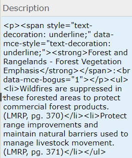

Susan_McClendon_NPS
I have an opposite issue.  We have a legacy dataset with a description field that already contains HTML formatting.  In Map Viewer classic, the field comes in with the HTML tags decoded, but not honoring the HTML in the display (i.e. everything default, no custom expression):
If I use new mapViewer and configure the popup for the related table value with a custom expression it gets worse, the html is displayed encoded:
// Filter related features by using a common attribute
var relatedData = FeatureSetByRelationshipName($feature,"FirePlanningLanguage")
var relatedDataSorted = OrderBy(relatedData, 'ActivationDate')
var popupString =''
for (var f in relatedDataSorted){
popupString += Text(f.ActivationDate, 'MMMM Y') + TextFormatting.NewLine +
"DeactivationDate: " +
DefaultValue(f.DeactivationDate, 'no data') + TextFormatting.NewLine +
"Description: " +
DefaultValue(f.Description, 'no data') + TextFormatting.NewLine
DefaultValue(popupString, 'No related language.')
We ETL the legacy data in FME, so we have the option of manipulating it or stripping the HTML there, but our end users would like to preserve it if possible.
Is there anyway to get the Arcade Expression to recognize the HTML and display appropriately?  Is there a different way to encode the field when we ETL in FME that would make it work?
TIA  ~ Susan

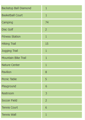

NicholasRutledge
It seems the new webmap doesn't use HTML coding. Has there been a solution to removing blank fields from the popup with the new version of webmap? If I go into the classic version of webmap I see where I have the "<span style="display:{expression/expr0}">" using attribute expressions coding I found from another thread on here but in the new version that code is removed. Below is a two screenshots of the two codes in each version. Seems like there would be a basic function to remove any blank fields from the popup without having to use coding techniques.
Screen Shot 2022-04-16 at 12.38.30 AM.pngScreen Shot 2022-04-16 at 12.36.41 AM.png
XanderBakker
Hi @NicholasRutledge ,
As of the December 2021 update, there is a different way to create HTML content in the pop-up. There are some blogs on this topic by Paul Barker:

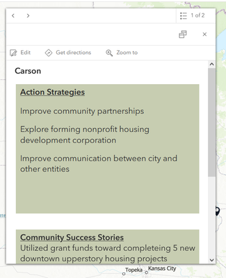

I am having an issue modifying the HTML script in wrote in a text box within the popup.  It will not allow me to modify the script in any way.  when I make changes, they are revert back to the original.  I am trying to change the color of the custom font and background within the popup the expression represents.  Would like to change the green to a blue.  any help is appreciated.  I have the webapp and feature layers set to edit.
krisam01
Occasional Explorer
Hi @XanderBakker and @KellyGerrow
Sorry to be joining this party so late.  This is an old thread and there maybe an easier or better way to do things in 2024. I have been reading through the threads and am struggling with the last step of my process. I have a text pop-up that I would like to have only display headings and attributes for those with data.
I have been able to use IFF (IsEmpty to have my pop-up not display data if there is nothing to display.  However I have not figured out how to remove empty spaces between the lines with no data displayed.
Here is my HTML:
<p>
    <span style="font-size:18px;"><strong>{Community_Name}&nbsp;</strong></span>
</p>
<div style="background-color:#c7cdb1;border-left:3px solid white;padding:0.4rem 0.3rem 0.3rem 0.6rem;">
    <p>
        <span style="font-size:18px;"><strong><u>{expression/expr0}</u></strong></span><br>
        <br>
        <span style="font-size:18px;">{expression/expr1}&nbsp;</span>
    </p>
    <p>
        <span style="font-size:18px;">{expression/expr2}&nbsp;</span>
    </p>
    <p>
        <span style="font-size:18px;">{expression/expr3}&nbsp;</span>
    </p>
    <p>
        <span style="font-size:18px;">{expression/expr4}&nbsp;</span>
    </p>
    <p>
        <span style="font-size:18px;">{expression/expr5}&nbsp;</span>
    </p>
</div>
<p>
    &nbsp;
</p>
    <p>
        <span style="font-size:18px;"><strong><u>{expression/expr6}</u></strong></span><br>
        <span style="font-size:18px;">{expression/expr7}</span>
    </p>
    <p>
        <span style="font-size:18px;">{expression/expr8}</span>
    </p>
    <p>
        <span style="font-size:18px;">{expression/expr9}</span>
    </p>
    <p>
        <span style="font-size:18px;">{expression/expr10}</span>
    </p>
    <p>
        <span style="font-size:18px;">{expression/expr11} &nbsp; &nbsp;&nbsp;</span>
    </p>
</div>
My expressions are variations on this:
return IIf(IsEmpty($feature.Action_1),"", "Action Strategies")
return IIf(IsEmpty($feature.Action_1),"", $feature.Action_1)
Here is an example of the output.
I would appreciate any help you can provide.
Thank you.
Amy
