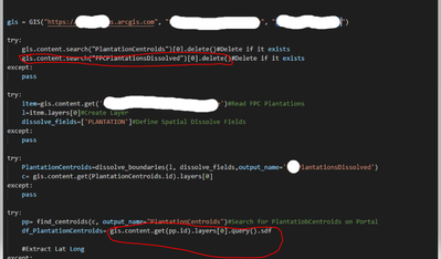

It basically depends on what lines it is skipping. Sharing a code snippet would have been useful. I had a similar issue where I was generating centroids and wanting to use centroid coordinates. What I did was to ensure the centroids are written on portal and on the consequent run, the code would search for the new write and utilize it. In other instances, I introduced sleep time to make sure latency was covered for. See code snippet below
