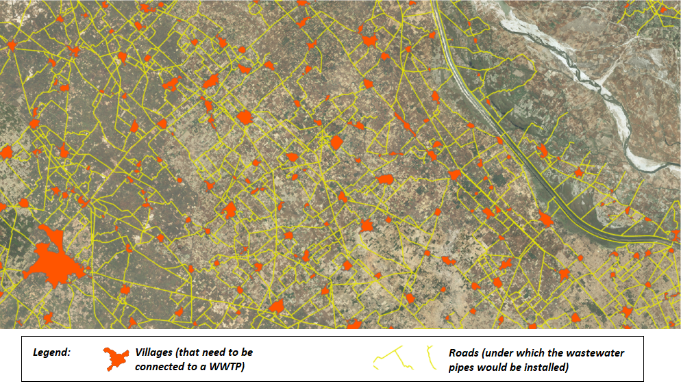

Hello all!
I have a study area of 400 km2 where there are around 180 villages spread (See picture attached). I am trying to determine the best location of a number of Wastewater treatment plants (WWTP) in a way that the distance from each village to the WWTP would be the minimum possible, assuming that the pipes will be installed right under the main roads that connect the villages between them.
I need to make the network analysis many times with the variation of number and location of the WWTP to determine the cheapest way in terms of number of WWTP and their location. The costss in this case are directly derived from the lenght of the pipes - which I assume is the same lenght of the roads under which the pipes would be installed.
I am using the Location - Allocation option in ArcGIS Pro, but I can not figure out how to set the options in order for the analysys not to consider the impedance but only the distance of the roads (because in my case the pipes and transport of wastewater will not be affected by the velocity on the roads, so I do not need to save time in that kind of transportation).
Could you please guide me? Am I using an incorrect tool? or maybe do I need to build a model to do the analysis that I require?
The main goal of my research is to define what is the best option for the villages in the study area: a wastewater treatment plant for each of the 180 villages? or how many villages I should connect to one WWTP in a way that the pipes would be as shortest ad possible, therefore reducing the costs associated with the pipes?
Thank you very much!! I really need a guidance on this matter.

If I understand correctly, you want to find the optimal solution that minimizes the distance along the roads from the villages to the wastewater treatment plant potential sites.  So, for your network analysis problem, you need to optimize distance rather than travel time.
You need to set the Travel Mode option (it's on the Location-Allocation ribbon) to use a travel mode that optimizes distance.  Your post doesn't mention what network data source you're using, but if you're using ArcGIS Online or Streetmap Premium, there should be a "Driving Distance" travel mode that solves for distance instead of drive time.  If you are using your own network dataset, then it's up to you to construct a travel mode on that network dataset that uses an impedance attribute that calculates distance instead of time.  If you clarify what type of network you're using, I can provide further detail on that if necessary.
