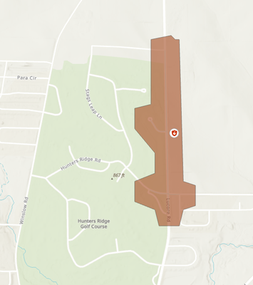

I'm using ArcPro 2.9 and trying to determine a 4-minute service area for fire departments. It will calculate distance fine, but as soon as I calculate in Time mode, I get service areas that are tiny. Could it be a connectivity issue with the edges?

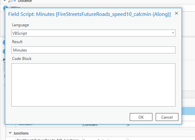

I have the Time Cost as minutes and it using a field in the attribute table called Minutes which is calculated already. But in the attribute table it is a Float. Could this be the issue?

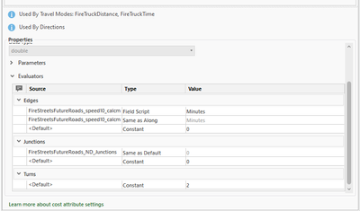

Your field evaluator setup looks fine. However, I notice you have a 2-minute delay for every turn configured under the Turns <default> evaluator. My guess is this is what's slowing everything down. Basically any time the traveler transitions from one street segment to another, they incur a 2-minute delay.

I changed the turn to 0 and now this is what I'm getting. 😞 I can't figure out why it's not calculating time. I've also tried making a new field in the attribute table that is a Double not a Float and recalculating minutes. I've made sure I am using the correct attribute field.
