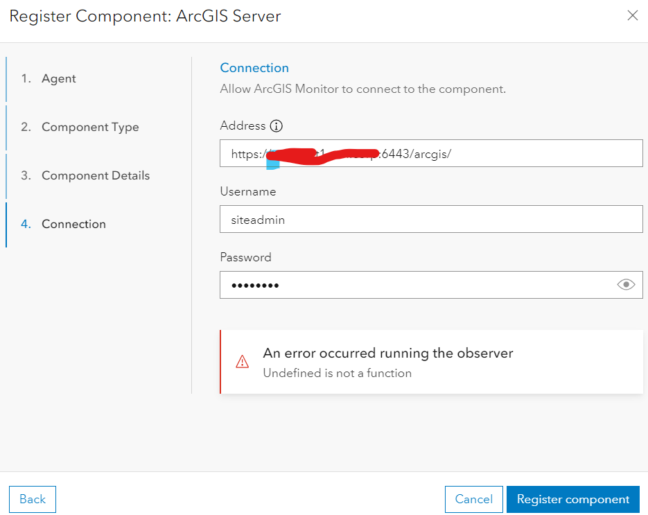

When I tried with Base URL (https://machinename.domain.com:6443/arcgis)with siteadmin credential getting the below error
An error occurred running the observer
Undefined is not a function

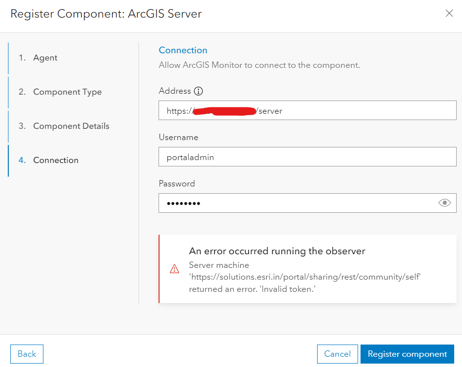

And When I tried with web adaptor with portaladmin credential getting the below error
Server machine 'https://solutions.esri.in/portal/sharing/rest/community/self' returned an error. 'Invalid token.'

Hi Tejpal,
I had similar issues registering our instance of Server. Dunno if this'll work for you, but in the end I tried using our reverse proxy name, with no port number, instead of the actual machine name and the connection went through. Hope this helps.

ReeseFacendini
Esri Alum
Log into the ArcGIS Server Admin API (https://server.name.com:6443/arcgis/admin) and click into Usage Reports on the far right side of options. Delete any reports that show an epoch timestamp (all numbers). It's a known issue with that release of ArcGIS Monitor, but will be fixed in the upcoming release.
