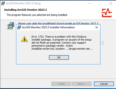

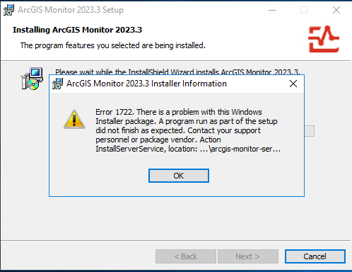

Installing ArcGIS Monitor 2023.3 Fails during Installation.
1999
7
12-21-2023 08:15 PM
MichaelRobb
Honored Contributor
There is a similar thread that seems to echo the same issue.
Windows Installation of ArcGIS Monitor fails before completion.
Calling @ Derek Law !
Similar issues:
https://community.esri.com/t5/arcgis-monitor-questions/arcgis-monitor-2023-1-upgrade-failure-there-i...
Just before this error, there are some CMD windows that 'flash' past...
anyone know the fix?
Attempts:
Ran using elevated permissions - no change
Ran using admin account - no change
Ensure the prior 10.8 install is NOT running in Windows Services  (as per directions by ESRI)
Ensure the Prior MongoDB Install is not running in windows services
Event Logs do not provide any meaningful information.

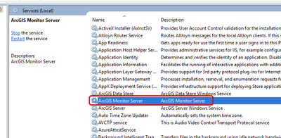

If you open Services on the machine where Monitor will be installed, do you see an existing ArcGIS Monitor service?
Josh
MichaelRobb
Honored Contributor
Yes, this is the machine with the ArcGIS Monitor Server.  As per the instructions set by ESRI, I turned 'off' during install.

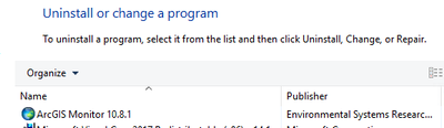

here is the control panel >> Programs list.

Hi @MichaelRobb,
In addition to Josh's comments, installing Monitor 2023. on the same machine that has Monitor 10.8.1 installed is not recommended, nor supported. Please see question 5 in the ArcGIS Monitor FAQ.

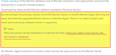

I will note that the upgrade instructions mentions to not uninstall previous version and that the install will upgrade.  nothing more.
ref https://doc.arcgis.com/en/monitor/latest/install/windows/upgrade-arcgis-monitor.htm
The help documentation you're referring to, is meant for ArcGIS Monitor 2023. So the statement is true, when upgrading from Monitor 2023.0, 2023.1, or 2023.2 - you can directly upgrade to 2023.3. It does not refer to Monitor 10.8.1.
