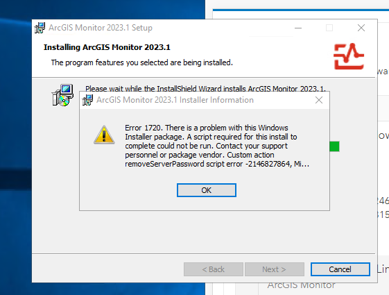

In attempting to upgrade Monitor 2023.0 to 2023.1, we ran into an issue where the installation would fail and then rollback the installation. Our first attempt in doing this caused our ArcGIS Monitor installation location to completely disappear save for three log files in ArcGIS/Monitor/bin/:
  • arcgis-monitor-server-service.err
  • arcgis-monitor-server-service.out
  • arcgis-monitor-server-service.wrapper
We managed to recover from a snapshot and get back up and running again. In trying to download the installer a second time, we checked the checksum and confirmed that it was correct however in trying to run through the upgrade, we were met with the same error again.
65BC35F7C463D731F690246B7FF95967D68030C3449A7793B05815F142FE7190
In looking in Event Viewer, we see the full message:
Product: ArcGIS Monitor 2023.1 -- Error 1720. There is a problem with this Windows Installer package. A script required for this install to complete could not be run. Contact your support personnel or package vendor. Custom action removeServerPassword script error -2146827864, Microsoft VBScript runtime error: Object required: 'WScript' Line 17, Column 1,
Not sure if anyone else is running into this issue with the latest installer but wanted to see if anyone else ran into issues upgrading.

Hi Alex, are you running the installer with administrative privileges?
AlexBakhtin
Yes I am - not sure if it also matters but the account I'm using to run the ArcGIS Monitor service is a gMSA. I just tried to re-run it and forcing run as administrator and got the same result.

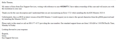

The second "issue addressed" on the 2023.1 release notes is about installation failing when using a service account. If I remember correctly, trying to install 2023.0 with a gMSA, it would start installing and hang partway for a long time (probably 15 min) before just closing out of the installer and giving me Error 1722. I put in a ticket to ESRI and received this response about it being a known bug:
