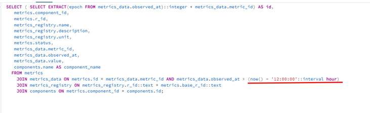

Hello again,
this limitation is applied on PostgreSQL level within metrics_data_view:
Why by the default it is limited so much?
