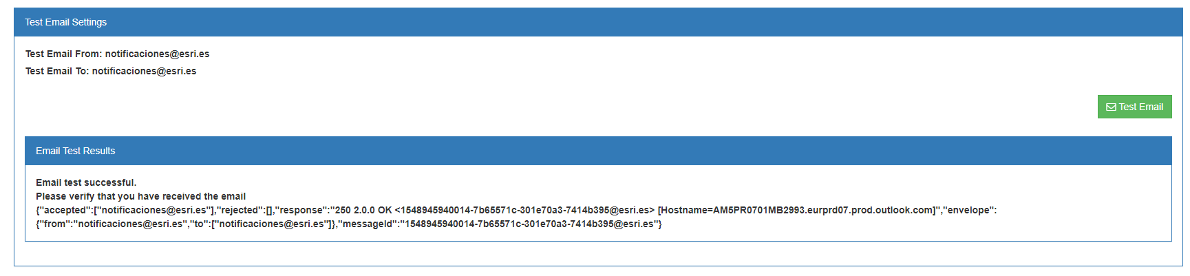

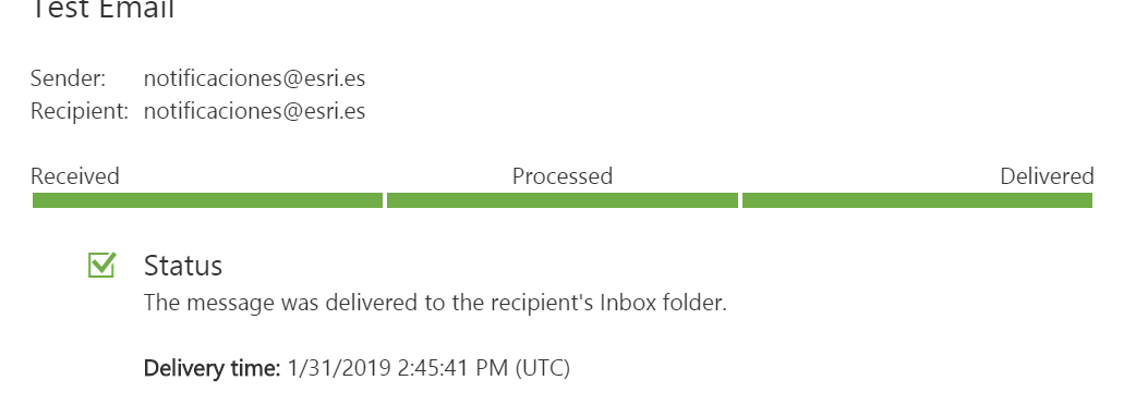

As we talked to Technical Support, in our ArcGIS Monitor deployed on AWS, Test Mail function is working fine, please see attached images:
ArcGIS Monitor Email configuration
Succesfully execution of Test Mail
Office365 trace log showing Test Mail execution
When an alert is triggered there is not activity in Office 365. We have also deployed ArcGIS Monitor internally (on premise) with the same SMTP and everything works fine.
