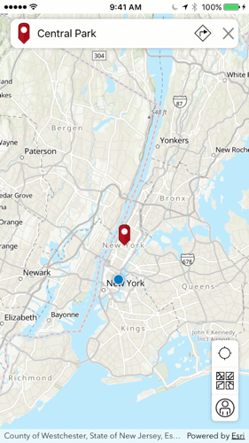

Search & Geocode

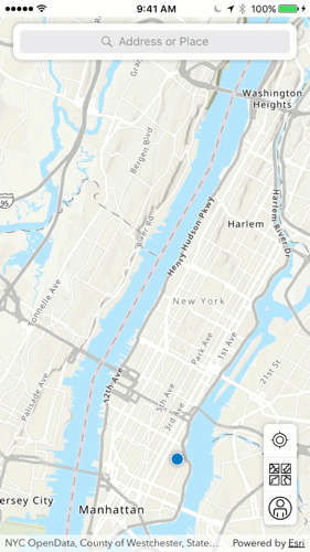

To search, simply start typing into the Search Bar at the top of the screen.
As you type, you’ll see suggestions appear, and you can either pick a suggestion or search for the text you’ve typed.
By default, you can search for places or addresses using the ArcGIS  World Geocoder, and the suggestions will prioritize matches close to the center of the map.

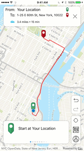

Turn-by-turn Directions
Whether you’ve searched or reverse-geocoded, the results panel includes a “Directions” button. Tap this to calculate directions from your current location to the search result.
At the top of the screen you’ll see an overview of the entire route, and at the bottom you can see turn-by-turn directions. Just swipe through them and the map will update to display the current step. If you ever want to go back to the entire route, simply tap the route summary at the top of the screen.
Note: Since the routing service consumes ArcGIS  credits, you'll need to log in to get directions. The ArcGIS Runtime includes a Credentials Cache and by default, if you've already logged in, the Runtime is able to intelligently make use of cached credentials to avoid prompting you for a login.
