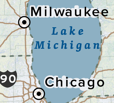

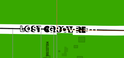

I use halos on nearly every map I make. When exporting a map with haloed text, though, they always look something like this:

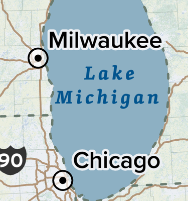

Here it is in Pro:
It seems that the halo itself is converting fine, but something's happening to the kerning.

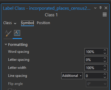

In Pro, my character spacing is set to 0%, and the labeling option I am using doesn't even have an option to spread.

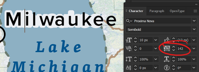

They should be 0 in Illustrator, then, too. When I hop over to Illustrator, though, I find that there are wildly different tracking values between characters.
rburke_6-1669832905987.pngrburke_6-1669832905987.pngrburke_7-1669832943974.pngrburke_7-1669832943974.png

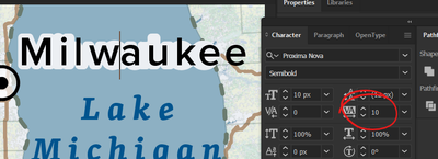

If I select all and set them to 0, it looks fine. Why is the export messing with that? Luckily this map doesn't have that many labels and Illustrator has some good tools for selecting similar text, but it's just a little boggling that Pro is putting out a file that has altered tracking values.
Please improve the conversion of haloed text by keeping the tracking at the value set in Pro.

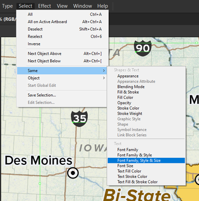

Here is the workaround for those interested: select one of your problem labels, then go to Select > Same > Font Family, Style & Size. Then, in the character window set tracking to 0. Character window can be opened from Window > Type > Character.
However, this does not work if you altered the spacing or if your labeling positioning settings have made it variable.

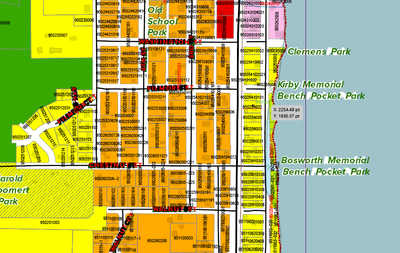

Even my legend text, which has no halo whatsoever, is messed up.
