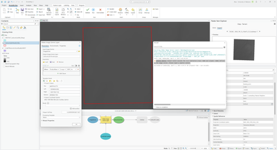

JiheeSeo
Hi,
I would like to use Terrain data (https://www.arcgis.com/home/item.html?id=58a541efc59545e6b7137f961d7de883) and have some troubles clipping it.
I followed the UC presentation above, but got an error. I clicked my AOI as "Template Extent" in Make Image Server Layer parameter.
WARNING 000950: Output raster exceeds the size limitation (rows: 5000 and columns: 5000) defined on the image server. Please input a smaller extent.
Could you please help me clipping the data?
