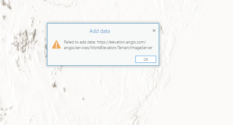

Hello everyone,
I am having trouble adding certain layers from the Living Atlas portal to ArcGIS Pro 2.5. For example, when I attempt to add the Terrain: Multi-Directional Hillshade layer I get the attached error (see screenshot). A number of other layers give the same issue. However, I am able to add certain Living Atlas layers without any problems.
I know I could just try use a layer that adds without issues, but my team has been using a map template which uses the Terrain: Multi-Directional Hillshade layer, so for consistency I want to be able to use this layer on my computer too. My colleague also has no trouble adding the exact same Terrain: Multi-Directional Hillshade layer which won't add for me.
Thanks in advance for any help.

your screenshot?

Jane_T
Sorry it's there now. Not sure what happened the first time around.

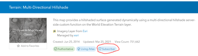

Jane_T
This is the issue. I wasn't aware that some of the Living Atlas content was subscriber only.
