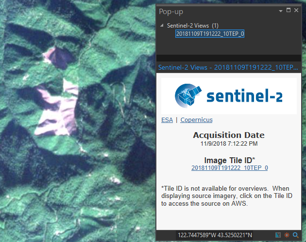

So what controls the default image date used for a given area? I have an area of interest (-122.745 43.525 Degrees) that I am monitoring using the Sentinel-2 imagery and that area was not updated between October 30th and November 19th despite the fact that there was a cloud free acquisition on November 9th.
This was what I noticed whether I was using the Sentinel Explorer app or my own Web app that I created where I stored my AGOL organizational account credentials.

Hi Steve,
There is a definition query controlling what default image dates will be available for any given area.  This is designed to show the most recent and most cloud free imagery.  This default query can be removed and you can apply your own query.
I just did a quick test over your location.  If I remove the default query and then apply a query for images acquired between 10/29/2018 and 11/20/2018, I get 7 images returned.  One of which was acquired on 11/09/2018 (20181109T191222_10TEP_0).  Hopefully removing the default query and applying your own will resolve things for you.

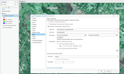

Hello, I´d like to know if I could be directed to a Tutorial that will help me use the Time Range in ArcGIS Pro which automatically appears once Sentinel 2 images are included from the Living Atlas on to the contents.
In the first image, I was able to filter the time extent to only show images for 2024.
How do I define that the time interval to be shown on the map are the dates acquired? This way, I can see the date acquired when the image changes
