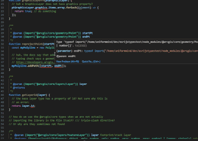

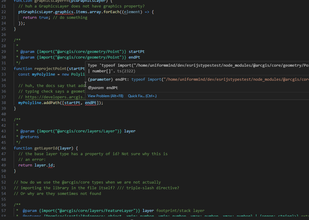

But if I try to do this in javascript using JsDoc approach there are all sorts of issues:
import Polyline from '@arcgis/core/geometry/Polyline';
 * @param {import("@arcgis/core/layers/GraphicsLayer")} ptGraphicsLayer
function graphicsLayerFn(ptGraphicsLayer) {
  // huh a GraphicsLayer does not have graphics property?
  ptGraphicsLayer.graphics.items.array.forEach((element) => {
    return true; // do something
 * @param {import("@arcgis/core/geometry/Point")} startPt
 * @param {import("@arcgis/core/geometry/Point")} endPt
function reprojectPoint(startPt, endPt) {
  const myPolyline = new Polyline();
  // huh, the docs say that add path can take an array of Point or number but the
  // typing check says a geometry is needed???
  // https://developers.arcgis.com/javascript/latest/api-reference/esri-geometry-Polyline.html#addPath
  myPolyline.addPath([startPt, endPt]);
 * @param {import("@arcgis/core/layers/Layer")} layer
 * @returns
function getLayerId(layer) {
  // the base layer type has a property of id? Not sure why this is
  // an error:
  return layer.id;
// how do we use the @ArcGIS/core types when we are not actually
// importing the library in the file itself? /// triple-slash directive?
// Or why are they sometimes not found
 *  @param {import("@arcgis/core/layers/FeatureLayer")} layer footprint/stack layer
 *  @returns {Promise<{spatialReference: object, xmin: number, ymin: number, ymax: number, xmax: number} | {error: string}>} extent or error?
async function fetchExtent(layer) {
  //https://developers.arcgis.com/javascript/latest/api-reference/esri-layers-FeatureLayer.html#queryExtent
  let response = await layer.queryExtent();
  return response.extent.toJSON();
function addEventToLayer(layer) {
  layer.on("layerview-create", () => {
    console.log("Success");
  layer.on("layerview-create-error", (e) => {
    console.warn("error");
I suspect I'm doing something wrong here with how I import these types. Does anyone know what the trick or proper pattern is-- specifically for JavaScript and JSDoc based type hints?

Hi @RyanSutcliffe ,
You need to import the classes at the top of your file.  Typescript allows you to import just the type but sadly JavaScript does not.  Then just use that named class as your `@param` in the JSDoc.  You may see some linting errors about the imports not being used though.

When you import the class and you type it like that, ptGraphicsLayer is of type constructor for Graphic, so it's like your telling TS it can do "new ptGraphicsLayer()".
You can use a utility type to help you out here with InstanceType.
import Polyline from "@arcgis/core/geometry/Polyline";
import type FeatureLayer from "@arcgis/core/layers/FeatureLayer";
import type GraphicsLayer from "@arcgis/core/layers/GraphicsLayer";
import type Layer from "@arcgis/core/layers/Layer";
import { Point } from "@esri/calcite-components/dist/types/components/graph/interfaces";
export function graphicsLayerFn(ptGraphicsLayer: InstanceType<typeof GraphicsLayer>) {
  ptGraphicsLayer.graphics.forEach((element: any) => {
    return element.id; // do something
Now everything is much stricter and you need to update the code a bit. There is no public graphicsLayer.items.array property. You might see it in devtools, but it's not publicly typed or doc'd like that, so I updated the code to reflect those changes.
Also anything you import that is only for types, you can add the "import type", it's really more for organization. TS should strip the import if it's unused or other bundlers will. But it will also give you a warning if you try to use it as anything other than a type, which can be useful.

RyanSutcliffe
Thanks @Sage_Wall that works I think. At first glance I had a bit of trepidation about importing all these types just for JSDoc types. Would that get tree shaken when the code is built or could this pattern add unnecessary size? But I guess, all these classes and imported functions are used somewhere in the codebase so maybe that's not an issue.
Accepting as the answer.
