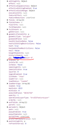

I have a code below that throws an error:
 [esri.WebMap] #add() The item being added is not a Layer or a Promise that resolves to a Layer.
Both `console.log()` statements execute ok, and the properties in returned object look like expected. The layer actually loads, but I get the error as I am not able to actually add it to the map.
I am actually implementing a custom Experience Builder widget with React and JimuMapView.

The one thing that could be relvant as well: When I console.log() the tileLayer object, it seems to have the right ID, but PortalItem property is undefined.
