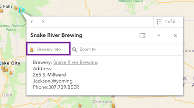

Trigger action is different from opening the popup. Trigger action is an event that fires in response to user clicks an action. This sample shows how to create custom actions for your popupTemplate. The action buttons are displayed like so in the popup.
The codepen was using deprecated method view.popup.open. I have updated the codepen to use MapView.openPopup method. We are passing the features parameter to the openPopup method so that the popup displays the popupTemplate associated with the graphics. Please take a look at the links I included in this response to learn about different parts of working with popup.
