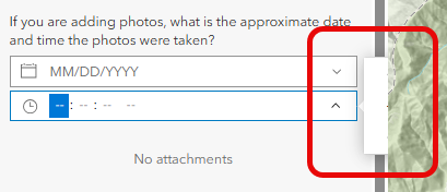

Reporter App: Submitting a report record in desktop view, the time picker is hidden under the map
335
07-03-2025 02:50 PM
RoryMcPherson
Using the Instant App Reporter template, when trying to select a time from a DateTime field, the time picker is displaying to the side and below the web map. As a result, I'm unable to select a time value. I can still manually type in values for hour, minute, second, am/pm, but cannot interact with the time picker. If you think it makes any difference, I have configured an editing form in the web map. The issue occurs both in the configuration and in the published app.

Hi @RoryMcPherson This issue is now fixed in both the Reporter and Manager Instant App. Please take a look and let me know if you have any questions or concerns. Thanks again for reporting this issue just in time.

RoryMcPherson
Thanks for the update @SubaKrishnan, and for fixing this so quickly.
