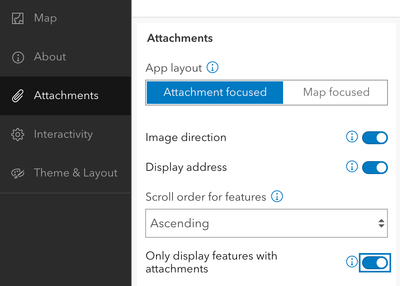

I took a look at the sample app that you have provided and I was able to pinpoint the issue. It looks like the app is running into a stop caused by the 'Only display features with attachments' setting being enabled in the attachment focused layout.
In the meantime, here are a couple workarounds:
- Disabling the 'Only display features with attachments' setting in the app's configuration experience which can be found in Attachments > Only display features with attachments.
- Selecting the 'Map focused' layout option which can be found in Attachments > App layout.
See screenshot below:
Hopefully, either of these workarounds work for you. But thanks for reporting this! We'll work on getting this issue addressed and fixed for the next ArcGIS Online update.
