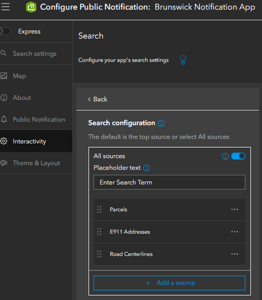

I was wondering if anyone else is experiencing this. The Search bar in the list-maker tab defaults to the World Locator Service and our own address locator instead of what I have it configured for. I have it configured for this:
JessicaHanscomBrunswickGIS_0-1720700661305.pngJessicaHanscomBrunswickGIS_0-1720700661305.png
and I get this:
JessicaHanscomBrunswickGIS_1-1720700704941.pngJessicaHanscomBrunswickGIS_1-1720700704941.png

@JessicaHanscomBrunswickGIS I'm unable to reproduce this, would you be able to share your app? I am seeing the search locator order respected and the placeholder text updated in my test.  One thing to check is that you have published the latest updates to the launched app.

@JessicaHanscomBrunswickGIS The table in your map is not loading and it's causing an error in the app which is impacting setting up search locators based on a layer in the map. We have an issue logged and will resolve this in the next update of ArcGIS Online. In the meantime, if you remove the Conservation Easement Properties table your app should work as expected.
That works! Search is back and you're my hero!
