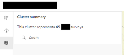

I have an Instant App (Enterprise v11.0) with an associated web map and feature layer configured to cluster points. When selecting a cluster in the app, the map pop-up (shown below) does not show a 'Browse features' button like Map Viewer does. This post is possibly similar to Browse features in cluster pop-up doesn't work in ... - Esri Community. Is this a bug or are there additional steps required to configure this?

Cluster results are not available in the Sidebar app when the popup content is displayed in the side panel. We hope to add support for this in an upcoming release.
